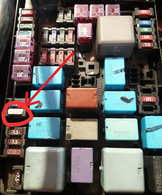

    Dear all,
    Just in case there is no topic about my following issue, pls guide me about what could be the damage in my Tacoma 2014.
    My Radio (factory radio) is turn off when I'm on my way to anywhere place, when this happen the Track Light turn on + the Roof lights + the Alarm doesn't work.
    The scanner (Toyota Agency) did not provide any Error code about this issue.
    I appreciate any info about this kind of problem if someone knows something about this and how can be solved.

    So all of those items work when the Tacoma isn't started or isn't moving? Sounds to me like an auxiliary fuse, but I am not sure because the situation you are describing is a little weird.

    No, any of the mentioned items are working while car is started or moving. The workshop revised the fuse box and all are ok.
    Yes, this is a very weir case.
    I will try removing the factory radio in order to see if the issue come from this.
    But anyway if someone have any info about this, pls let me know.

    Sounds to me like a fuse man, it only takes like 10 minutes, I would check em all real quick...

    Has any electric mods been done?
    Check electrical connections, sounds like it is shorting out somewhere.

    Yes, before of this issue, I changed the front speakers.
    I will check the connections in order to see if something is wrong.

    This is just to let you knows that I found the fuse which was making the problem.
    skedrc you was right all the time. Very good! I removed and return back below fuse and all back to normal.
    See on below picture the fuse. The funtions of this Fuse as per Owner's Manual is: Wireless remote control system, air conditioning system, multiplex comunication system, meter and gouge, front passenger occupant classification system, garage door opener.
    Hope that this info can help to anyone in the future.
