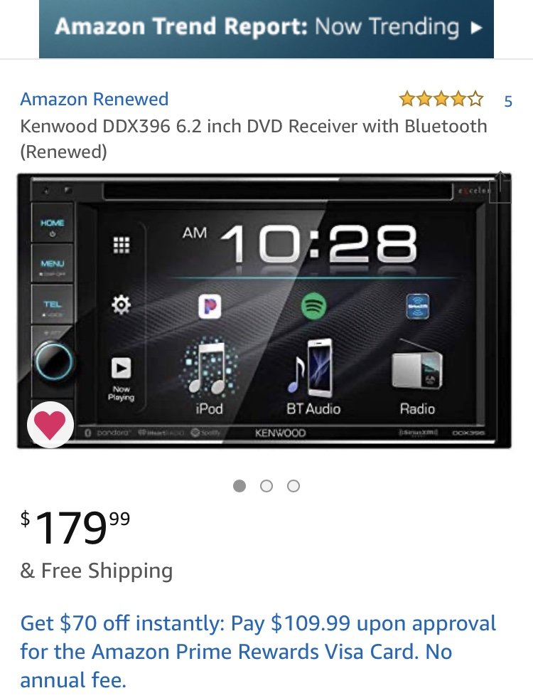

    Hey guys, I am looking to upgrade the radio in my Tacoma. My sound system is fine as I have the stock JBL system, so just looking for a radio.
    It would be ideal if I could find a radio with all of these features.
    Double-Din,
    Spotify Control,
    Bluetooth,
    USB Port for charging and music,
    Stock Tailgate Backup Camera is compatible,
    Steering wheel controls compatible,
    Not a slow piece of junk,
    Around $200.
    here is the one I’m looking at and is suggested by Crutchfield. Opinions and pictures of yours would be appreciated! Thanks!
    UPDATE: I now plan to go through Crutchfield with this radio, iDatalink Maestro, and adaptor for steering wheel controls after saving enough money. Just a broke college student for now.:facepalm: Would still love opinions and/or pictures. Thanks!
