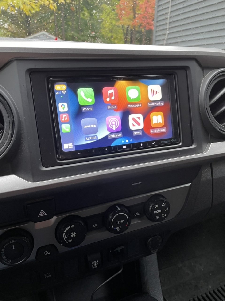

    My factory setup started dropping phone calls after 2 minutes, and having other annoying Entune weirdness after a phone update earlier this year. The only real fix for that bs is a new head unit. I finally swapped my factory head unit out for an Alpine ILX-407 along with a KTA-450 power pack this week. This amp fits nicely behind this head unit because of the short depth- there’s no CD player. Makes for a very clean install. I purchased everything from Crutchfield at the beginning of September.
    I swapped out all the factory speakers when I added sound deadening to the doors and back wall. The new head unit was the final piece of the puzzle. CarPlay is way better than Entune- I don’t know why Toyota even bothers with their own system at this point. On the ILX-407 CarPlay isn’t wireless, but after having all the issues with Entune via Bluetooth, I’m kind of enjoying not having to f with pairing my phone. You just plug the phone in via the usb in the console and you’re good to go. I still need to spend some time messing with settings and change the wallpaper, but this new Alpine unit has been great so far.

    That looks like it may fit my bezel without needing to find a premium bezel. I like the clean oemish look! Good job!
