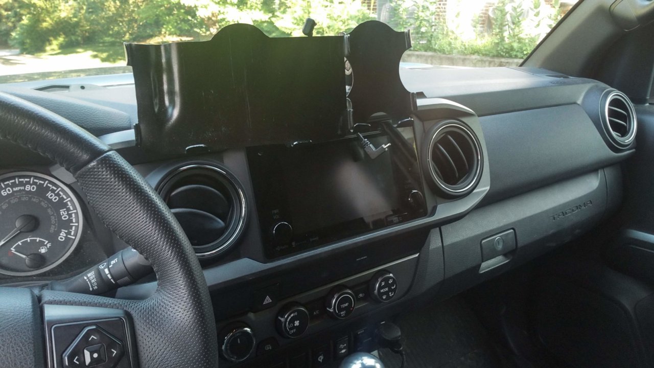

    I had the dash apart to run a new USB cord up behind the radio. I have had the dash apart and the radio out several times in the past with no trouble.
    This time, after putting it all back together, the radio won't turn on when I turn on the truck. I've checked the three fuses under the hood and they are all good.
    What am I missing?!?
    2019 Access Cab, Sport trim, MT.

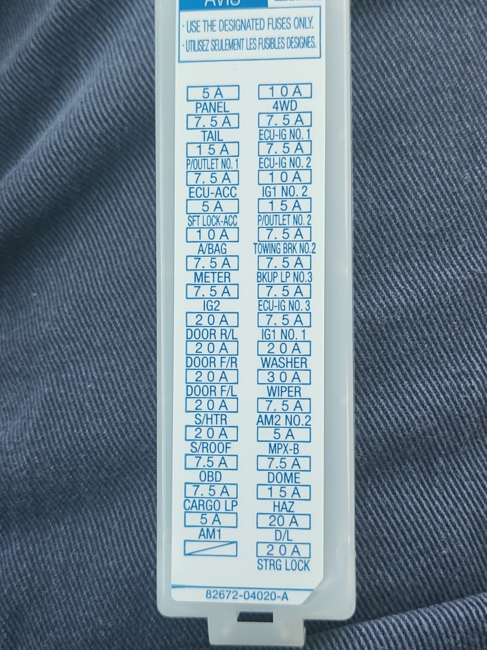

    I looked in there, but did not see any that are specific to the radio. Do you know of one that is?

    Alright. It's the best case scenario. I was just an idiot and missed a plug. Thanks for all that indulged me.
