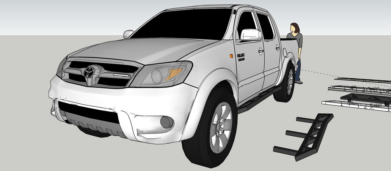

    Just wanted to make you aware of the angle discrepancy as a courtesy since you were so good to share that cad file.
    Are you kicking the sliders up at an angle from the square body bar? The guys here say that ones that stick straight out get hung up on things, that's the reason I'm angling my design up at 22 degrees

    I'm not sure on the kick up yet. Since I'm still paying payments on the truck it won't be doing any serious off roading in the near future. I would like them as a suedo step to get to the roof rack.

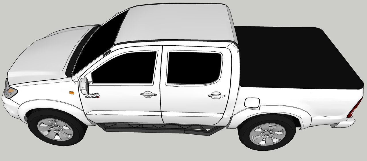

    Here is my latest iteration, Using plate between the main rails in leu of tubing. Right now I'm showing 1/4" plate for the "webs" but may wind up going thicker depending on what we have laying about in the shop.
    I'm also going to revisit the webbing angles to create a truss-like angular assembly.
