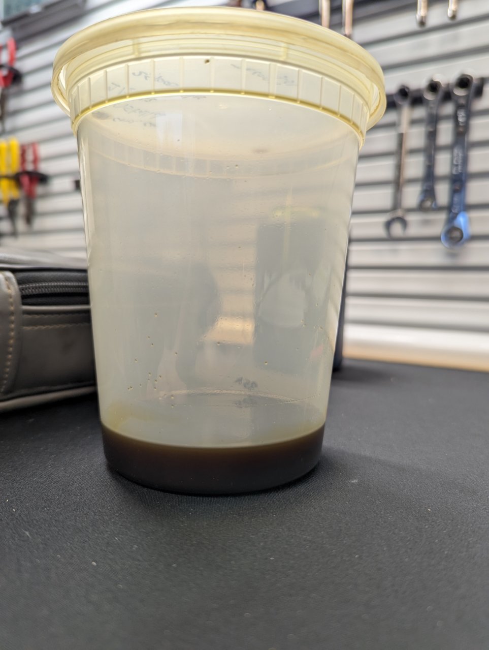

    I have a basic jlt single catch can, this is how much oil it's collected in 10k miles of mostly highway driving. You can imagine how much oil that will be over a few years, 150k miles.
    I dump it every other week when cleaning the truck, and plan on cleaning the catch can filter every other oil change. Easy preventative maintenance. :cheers:

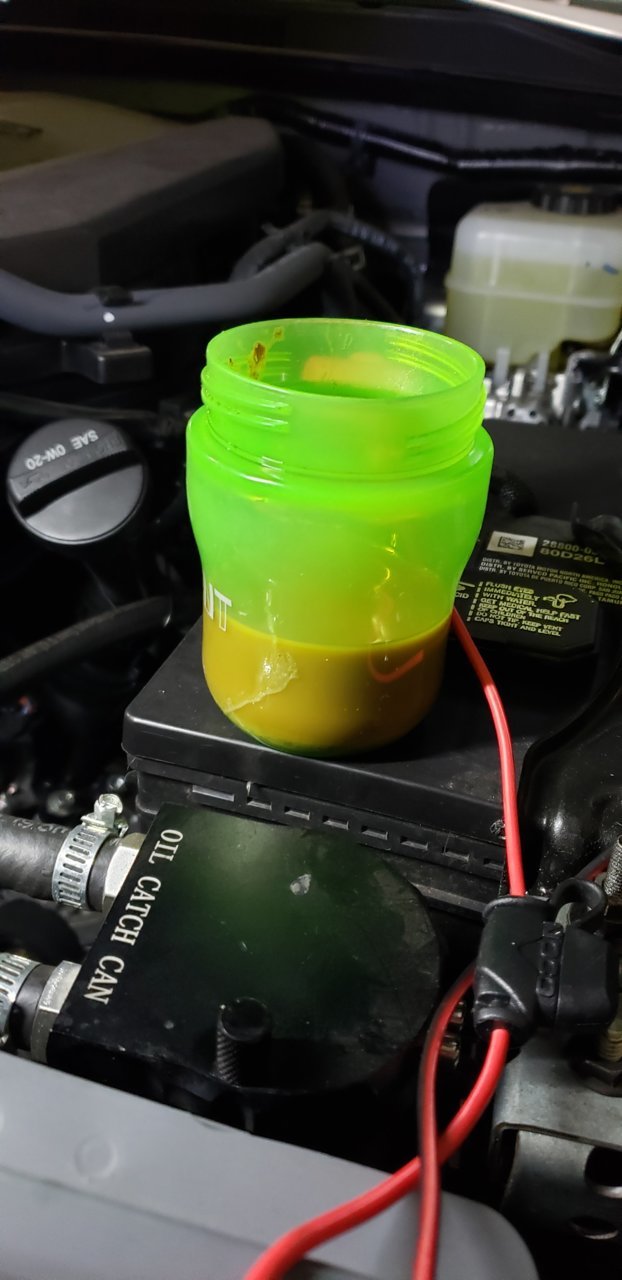

    I get more in the colder months due to better condensation. Attached picture is probably 4-5k worth. If the cheap CC I helping that not make it into the intake, definitely worth it.
    Our other car is a non mpi GDI and I get more actual oil mixed in with the creamy goodness. Pretty nasty stuff.
