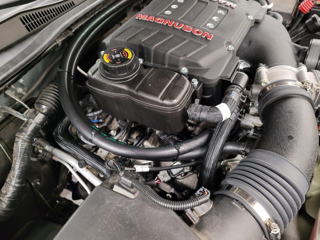

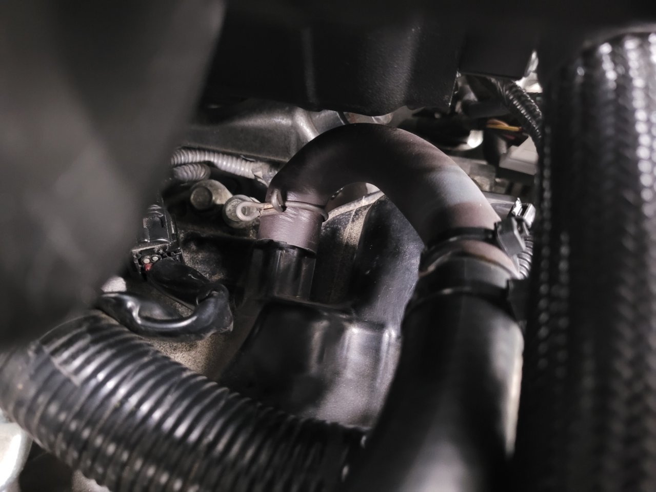

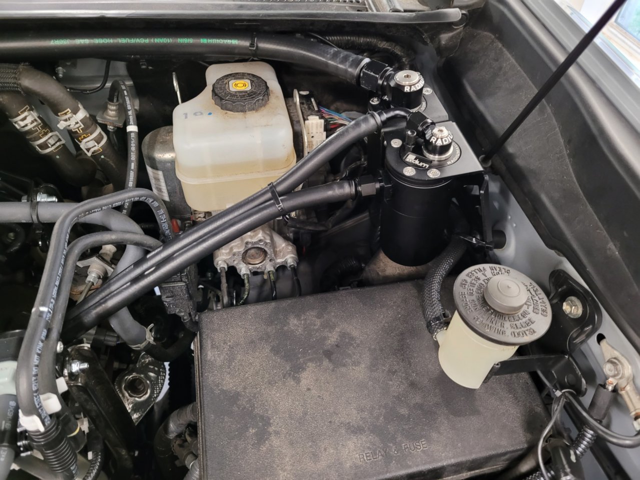

    For those MT guys that are interested, I managed to work a solution for having the Radium dual-catch can setup in my MT truck.
    I had a buddy modify the clutch reservoir bracket. All he did, was weld it to a small piece of sheet metal and drill a hole so I should attach it to the bracket just above the fuse box. I got some new hose (You need about 24-28 inches) to run from the reservoir to the port on the firewall.
    This setup has worked really well - I really like the quality of the radium catch cans.
    For anyone that has a Magnuson Supercharger, of note is that the recommended length of the CCV lines to and from the CCV catch can need to be longer (about 46-48 inches) than what they recommend in the directions, due to hoses having to go around the supercharger upper/lower manifold.
    Also of note with the supercharger, the upper/lower manifold also inhibits the CCV valve cover vent hose connection by creating such an angle the hose will kink. I used the original hose that has the 90 degree bend in it, cut it after the bend and used a 5/8" to 5/8 inch brass barbed coupler with the Radium CCV hose.
    One last thing I had to deal with, is my Redline hood struts. I used 22mm spacers on the dual catch can bracket to make enough space between the cans/bracket and the hood strut (note the first image).
    Again, I am very happy with the dual catch can setup from Radium and although it took a little extra work I'm glad I was able to make it all work with my setup.
    - Jeremy

    Nice! I have been waiting to get one due to me having a MT. Your solution is great, I also think you could mount it where a lot of people mount ARB compressors/2nd batteries on the passengers side of the engine bay.

    You are right, there is definitely plenty of room on the passenger side. I considered using a Rivnut tool to mount the bracket on the passenger side, but the dual catch can bracket has an angle to it since the clutch reservoir bolt locations are at an angle. I didn't want to attempt trying to bend the dual catch can bracket (the craftmanship is too nice!) so sticking with the clutch reservoir location is what I went with.

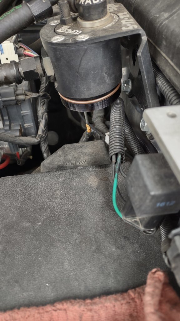

    Whoops, missed these.

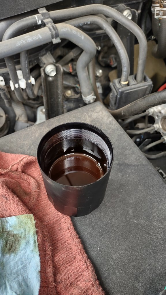

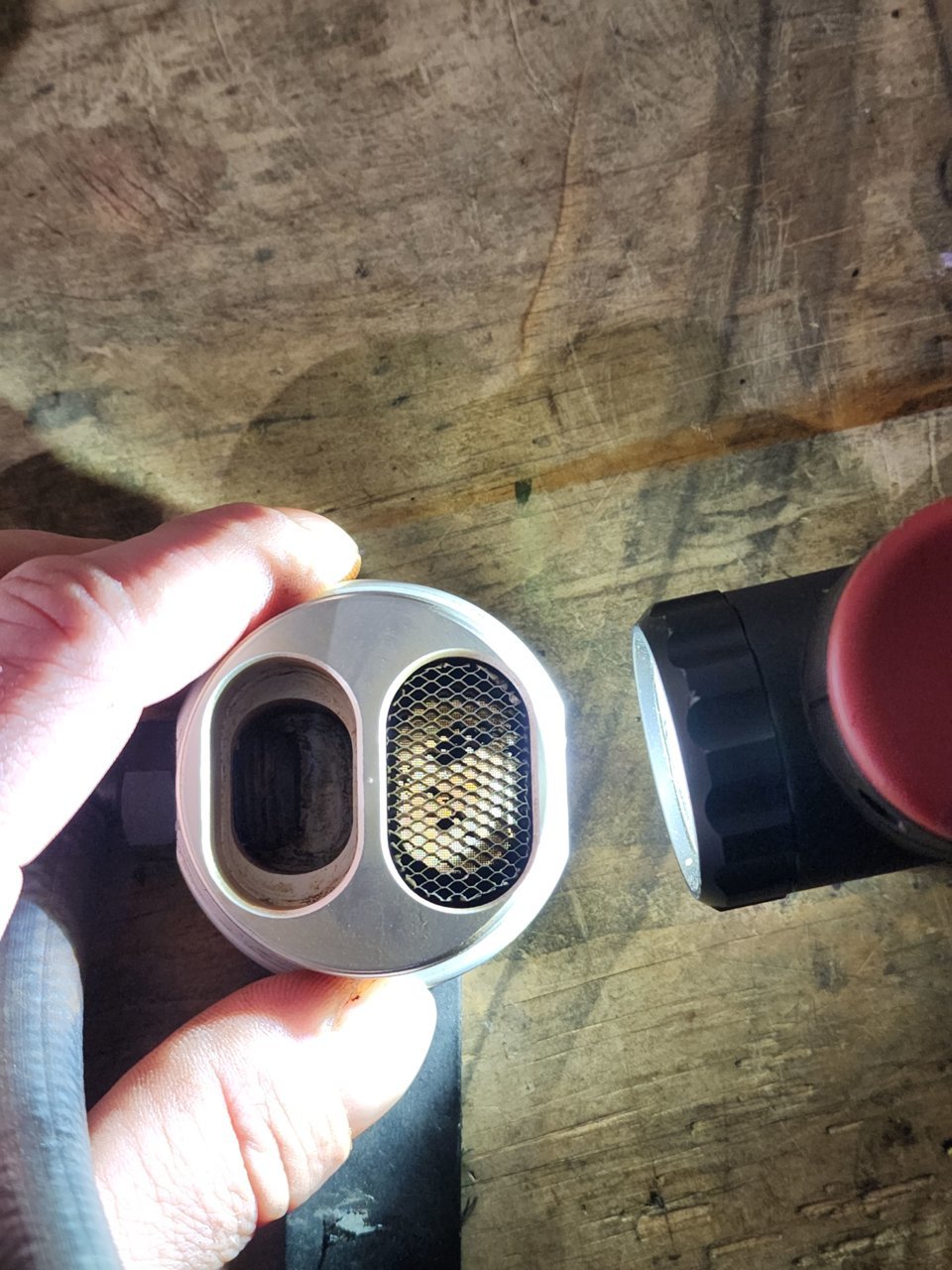

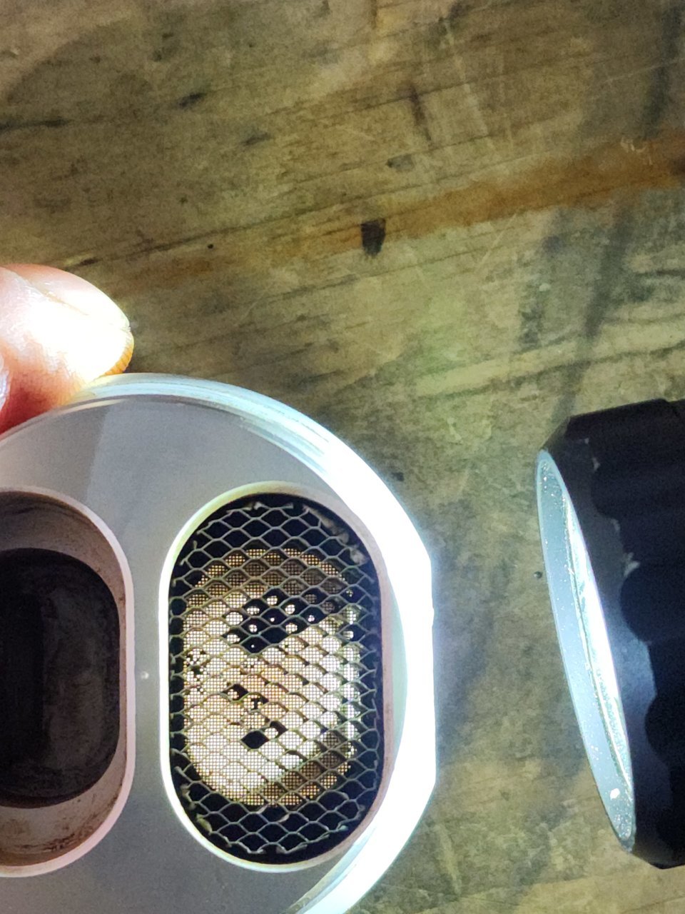

    5-14-2024 at 70K
    IMG_20240514_145355621_HDR.jpg IMG_20240514_145350382_HDR.jpg IMG_20240514_145341308_HDR.jpg
