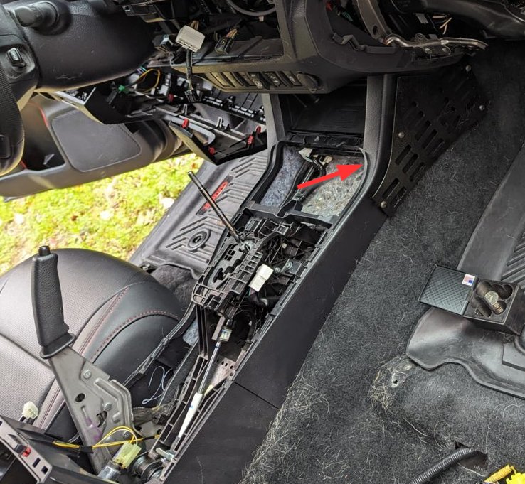

    Has anyone installed one of these? I purchased one, but installation is nothing like their video…of course! I cannot get behind the plastic sides like they showed.
    Any help/suggestions would be appreciated!

    I don't have Rango, but when I did mine I pulled the shifter panel up, then used needle nose pliers and a box wrench to hold hardware in place while I threaded the hard to reach ones.

    I for the Victory 4x4 molle panels, but I found it easier to just take the center console out to install

    I may have to take the console completely out. Just have to figure out how.
    Thanks guys for the suggestions!

    Here is a good write-up on accessing pretty much every part of the dash:
    https://www.tacomaworld.com/threads/installing-mesojdms-custom-lower-switch-panel.539029/
    Skip the dashboard and leap straight to the console part.
    I personally preferred not to, because pulling that meant pulling the ENTIRE center console, from storage box to phone charger.
    I just snuck in behind here with my long handle tools.

    I have the rago panel on mine it just takes time and patience and alot of cursing. But it can be done took an hour or two
