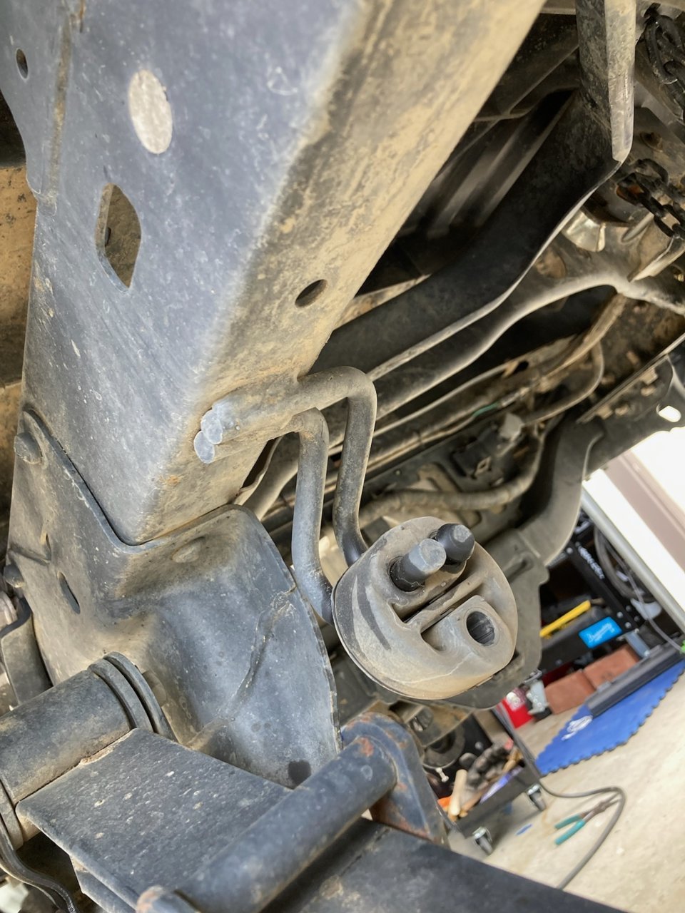

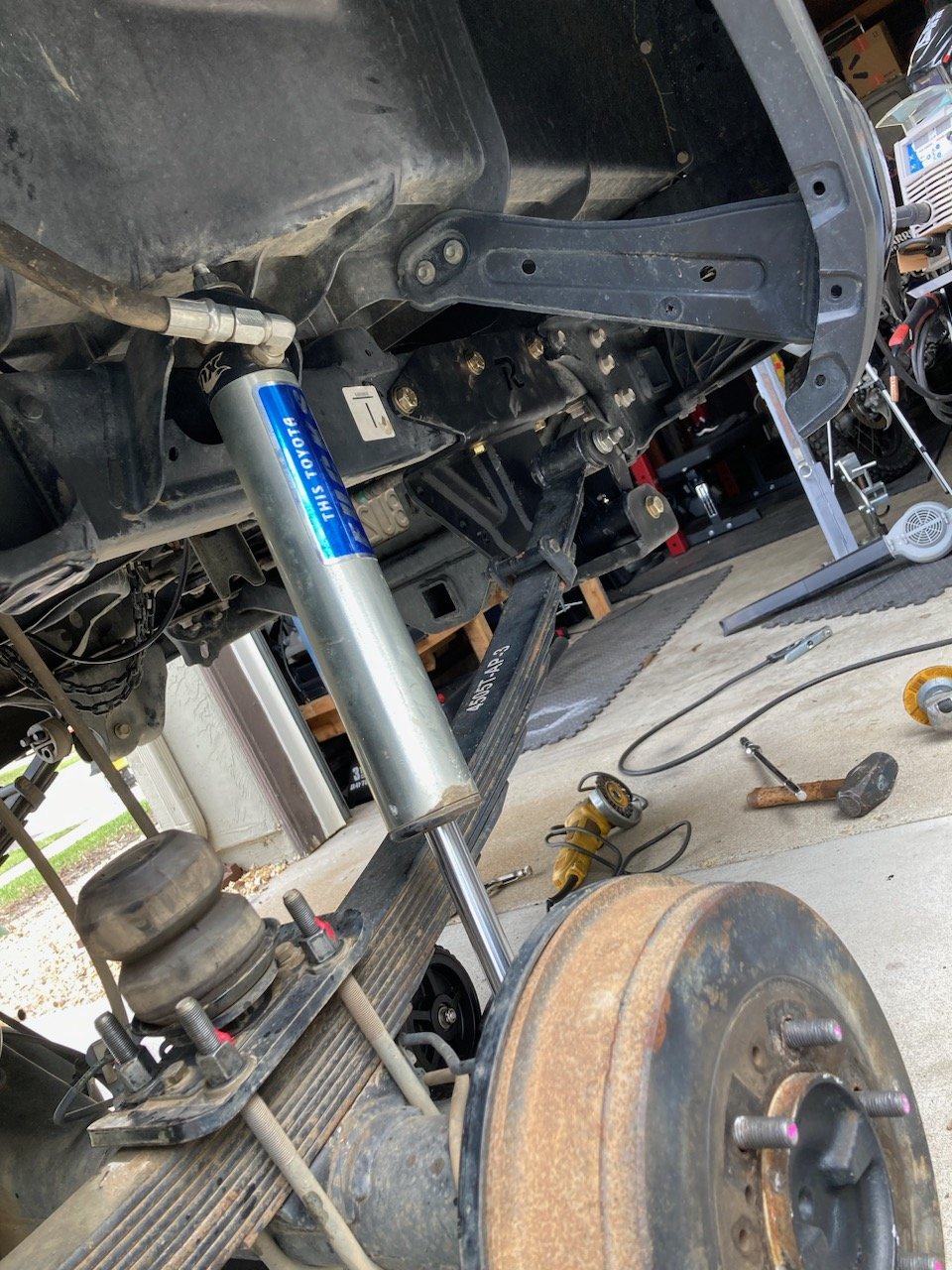

    I think I have bent hangers since both of my leaf springs make contact with my shocks. Just ordered some Rago hangers hoping it fixes the geometry of the springs.
    Update
    With all pro leaf springs
