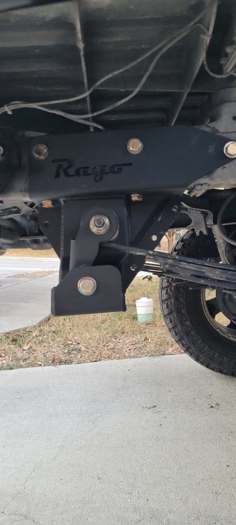

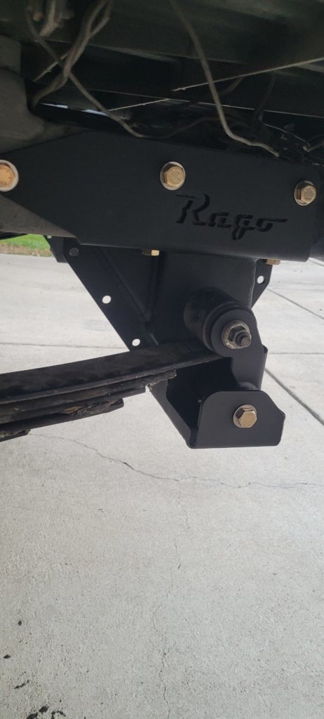

    So I just installed my Rago hangers yesterday and didn't have to remove the entire leaf pack. (OME HD with 2 3/4" lift)
    I just stuck that good ole factory bottle jack between the frame and the leaves and cranked the leaves down as i needed room. Also helped to get the shackle bolt right where I needed it. Just a good tip for anyone else replacing leaf pack, or installing hangers...
