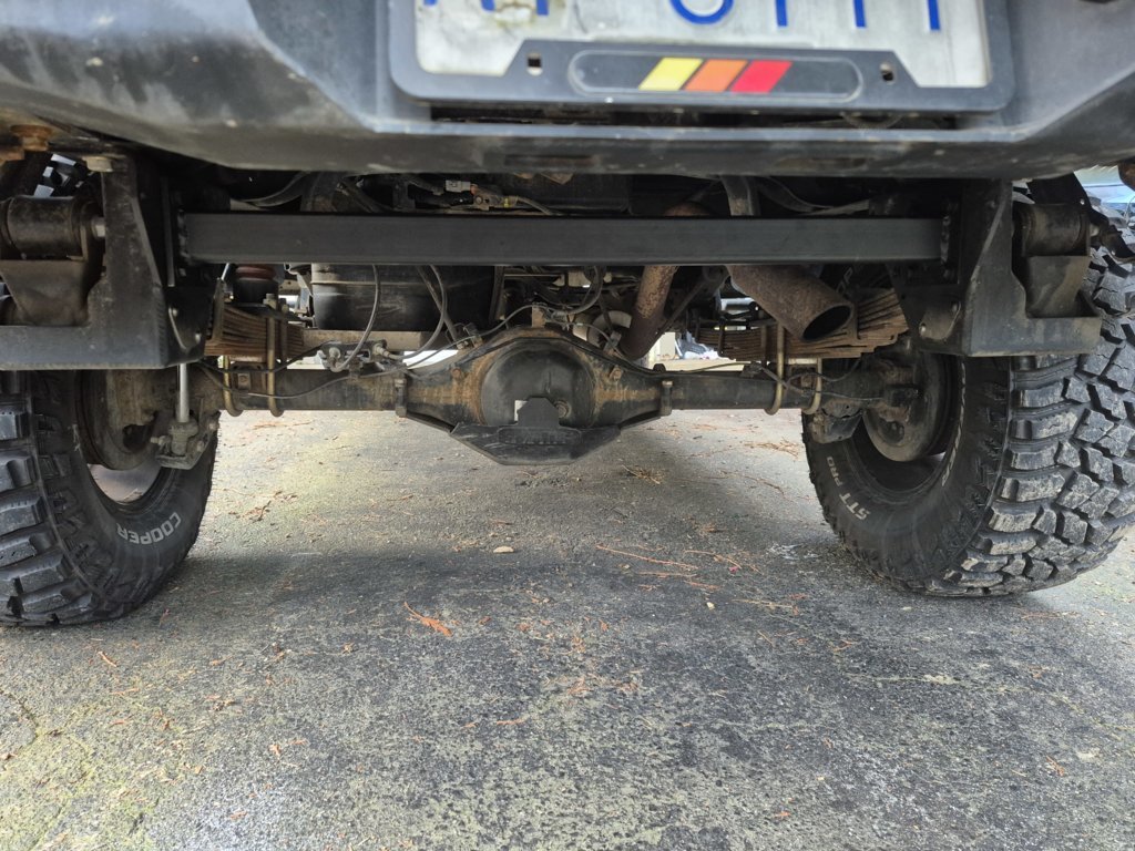

    I installed these and everything is great but wondering if anyone has done a cross tube for these specific hangers if so did you weld them direct to the hangers? how did you avoid weld bend? If you made brackets where did you mount them? Show me options if you have them.
    I like the active design for clearance but straight across woud be fine too.

    Well I did it

    No, I haven't tested it offroad yet but there is a big flat spot on the rago hangers that's hollow behind I drilled and tapped 3/8 bolts into and bolted up a crossbar my buddy welded up for me.... looks good and high enough for clearance
