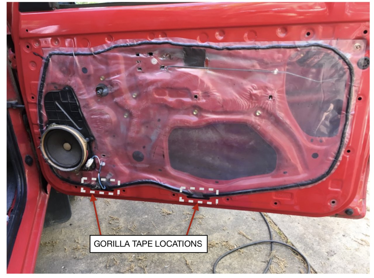

    I've had a rain leak on my passenger side for awhile. It was somewhat intermittent but annoying. Lately, it has seemed to worsen so I decided it was time to track it down. It was due to deteriorated tape inside the door in an area Toyota calls the drain-back. The tape works in conjunction with the interior vapor barrier to direct water to the door bottom drains. Water was splashing against the backside of the door trim and dripping into the cab.
    I've attached a pdf write up showing removal of the door trim and vapor barrier, replacement of the butyl tape, clean up, reattaching the vapor barrier, and drain-back hole tape. Hopefully, this will be helpful to anyone else with the same or similar problem.

    Thank you for this! Where did you put the gorilla tape? My eyes are missing it

    Sorry, I failed to get a picture of the Gorilla Tape. It basically went back in the same place as the original yellow factory tape. I cut 2 strips 2" x 5" and centered them on the drain back hole areas - the same place as the original tape.

    I edited the write up to include some dashed lines showing the Gorilla Tape locations. Version 2...

    Ah! I relined my doors because my passenger side didn’t have a barrier and I don’t think I did this...

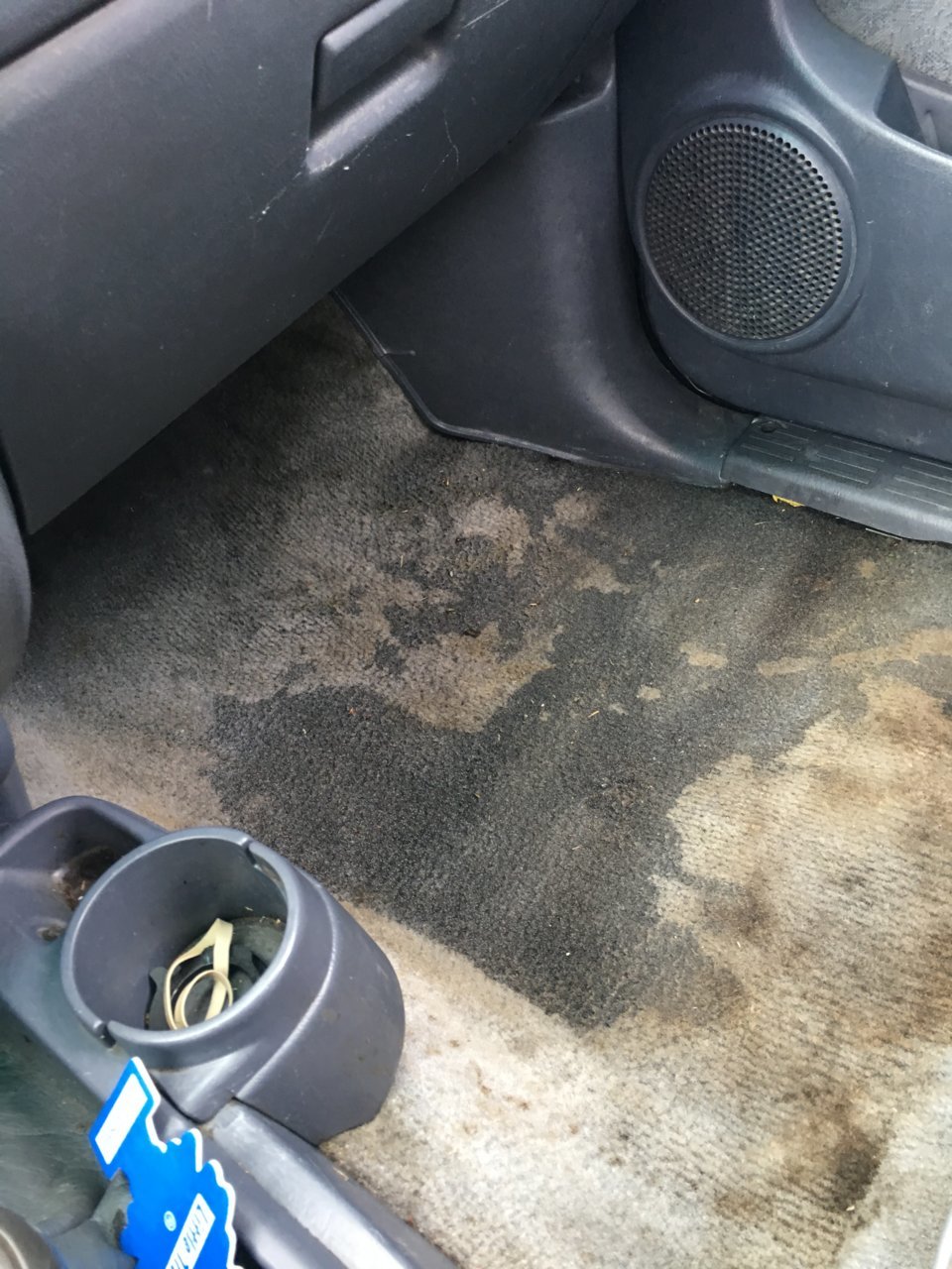

    I've got a similar leak but on the driver side only. Door seals have been replaced, and vapor barrier is in good shape. I even have soundproofing material covering everywhere the vapor barrier is. It seems to originate from the front and run to the back floor board. It is hard to tell exactly, because when it happens which is intermittent it soaks the whole forward floorboard. I thought Firewall, but can not see any areas where water would come in. Any ideas?
