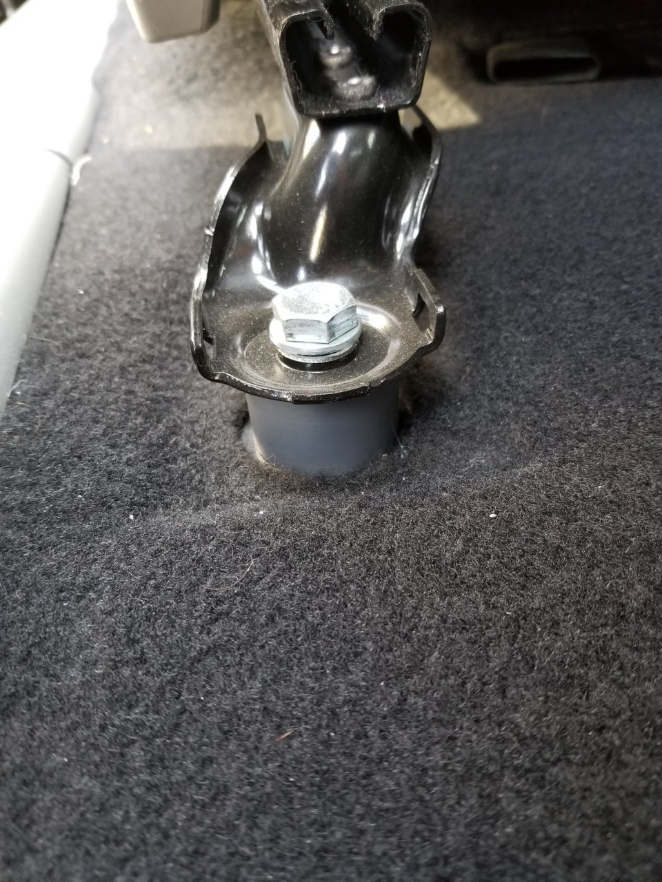

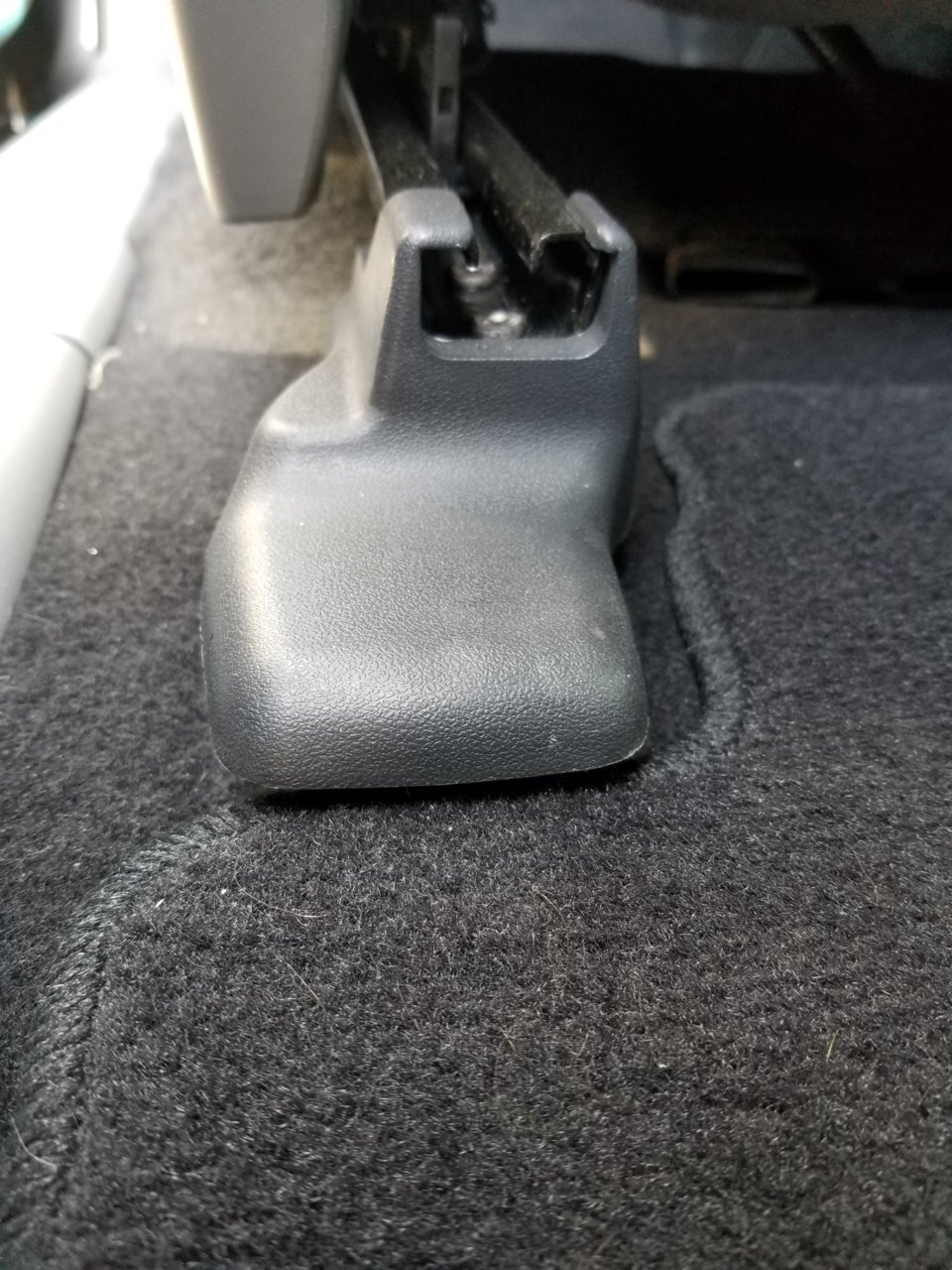

    Can someone post pics of what this looks like in their rig please?
  6. Apr 5, 2018 at 2:15 PM
    #26
    cmbondo
    cmbondo Well-Known Member
    Feb 2, 2014
    #122060
    564
    San Diego CA
    2021 Cement DCSB TRD Offroad
    FOX 2.5 DSC and some other stuff too.
    One uncovered and one covered. Barely noticeable when covered.

    Thank you cmbondo and skatefreak.
