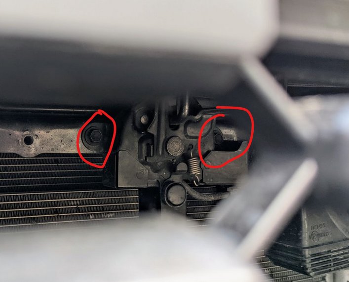

    Hopefully just these two...

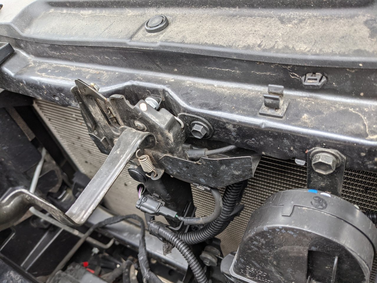

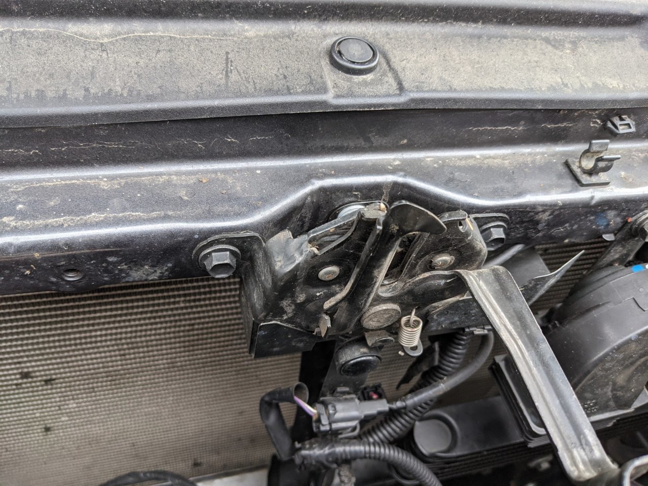

    I'm not certain its just those 2 bolts and even if it was the release cable will limit your movement upwards. That said if you can get behind the latch and trigger the release you'll be in business
    Couple more pics

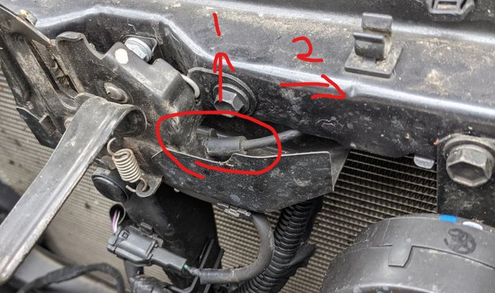

    Is this the release cable protected by that shroud? If so, you should be able to pop it up and then pull it to release the hood.

    Yeah, that is the release cable.
