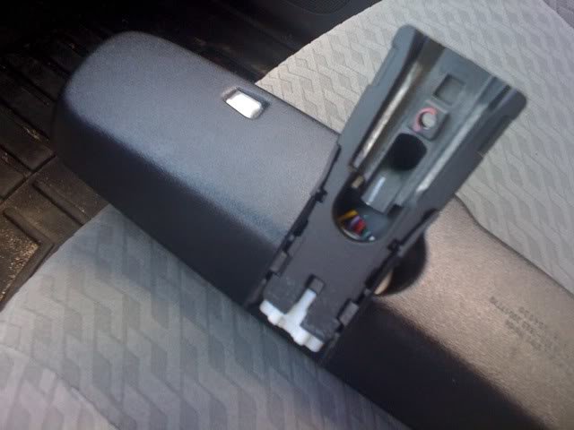

    1)
    First you need to disconnect the mirror from the button that's on the windshield. There is a little allen key that needs to be loosened.
    You will need to remove the black plastic cover that hides the wires. The wires will be tucked up in the headliner so you won't see the wires anyway.

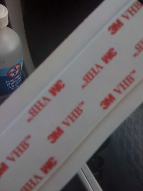

    3)
    Cut a piece of 3M tape to fit the flat area on the mirror mount

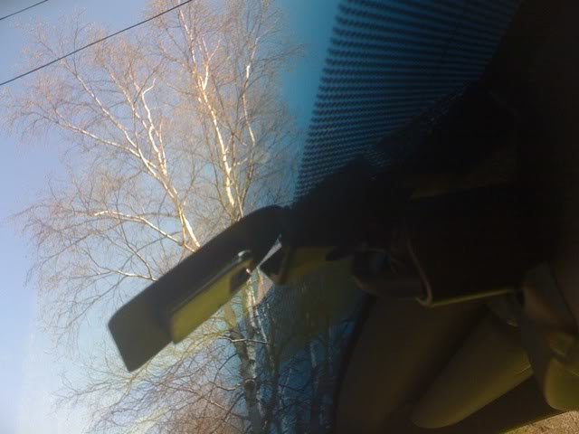

    4)
    Push the wires up under the headliner. Line everything up, make sure the mirror is as high as possible, and then push the back of the mirror mount against the windshield. Make sure that the sticky tape doesn't touch the windshield until you have everything lined up.

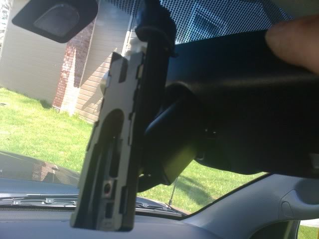

    5)
    In this picture you can see how much higher the mirror now sits. I left the button on the windshield. You can't see it when your driving because it's behind the review mirror.
    Like I said, I'll let you guys know if it holds up or not.
