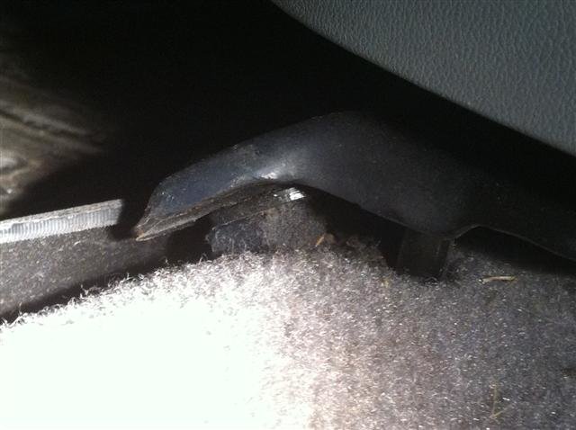

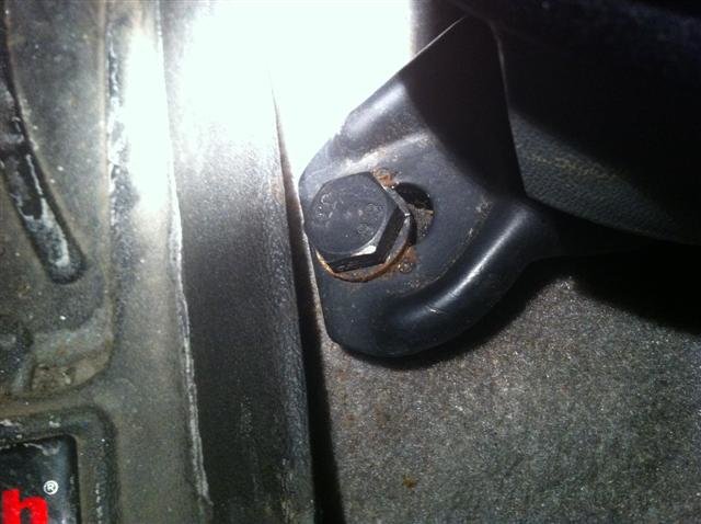

    I always felt I was sliding out from my sport seat.
    I tilted the seat (not the back which is adjustable) about a 1/2 inch from the front.
    I elongated the front bracket holes .Got longer high grade bolts,1/2 inch nuts and 2 washers. AND the dremel with a grinding stone drum.
    Loosen rear bolts ,grind holes,insert nuts and washers.tighten all bolts . DONE !

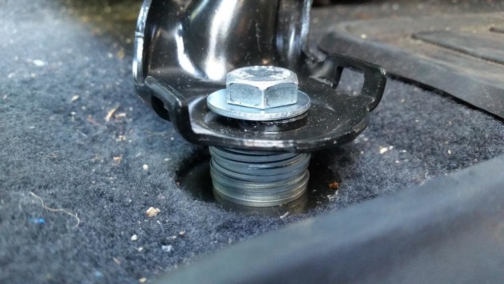

    I hope none of you that are doing this are ever in a bad accident seriously. Those seats are where they are for a reason. Think of it as a body lift. A bad enough impact and body pucks snap and your cab, bed becomes a projectile. Same thing by adding that stack of washers to your seat. If it bothers you that much get a seat pad (still not really recommended) or reconsider the tacoma as the truck for you. I'm not saying it's not going to work. I'm simply stating the risk factors associated with it. And even if you never have an accident. What happens 3 years down the road you trade it in and forget about that and the next owner gets into an accident

    I did a solid pvc puck on my last jeep and raised the seats 3/4 of an inch it made a huge difference. Like some of you have mentioned I upgraded the seat bolts. Im 5 7" I think its safe to say if I were an inch higher in cab the air bag would still deploy and smack me properly.
