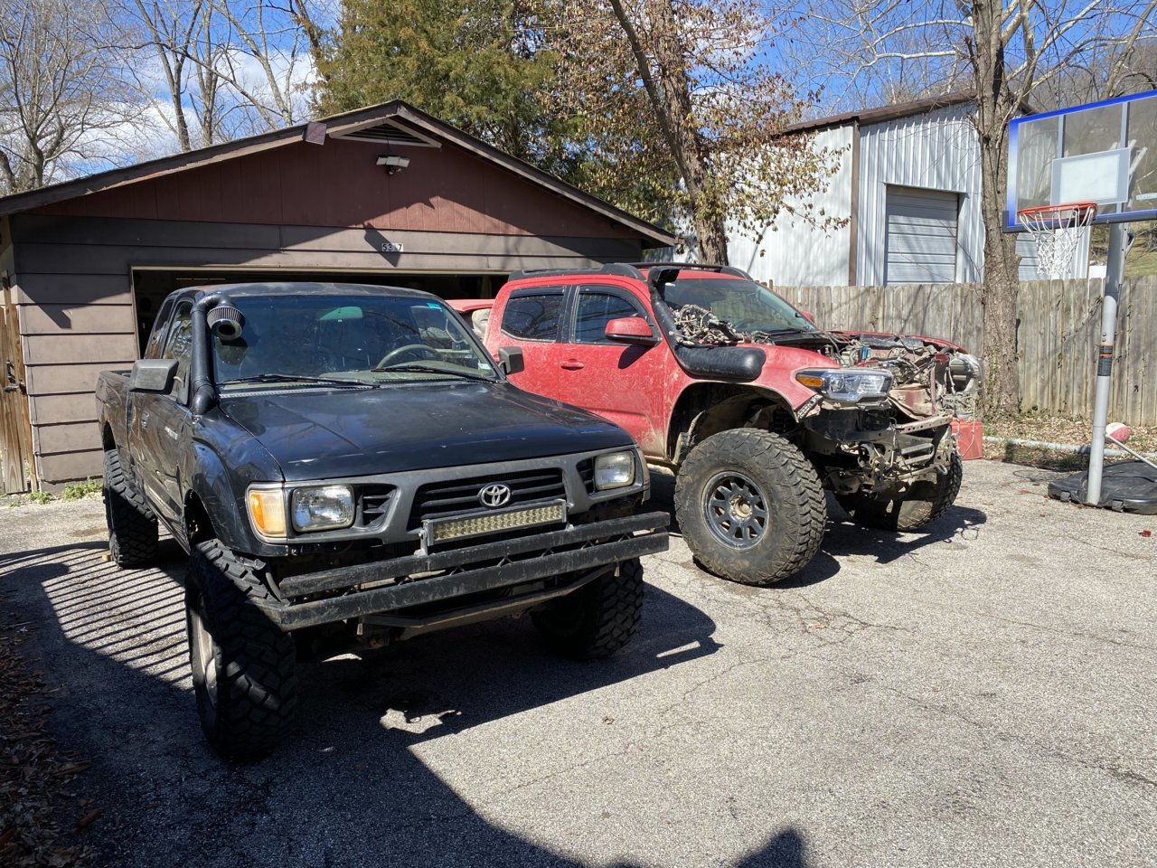

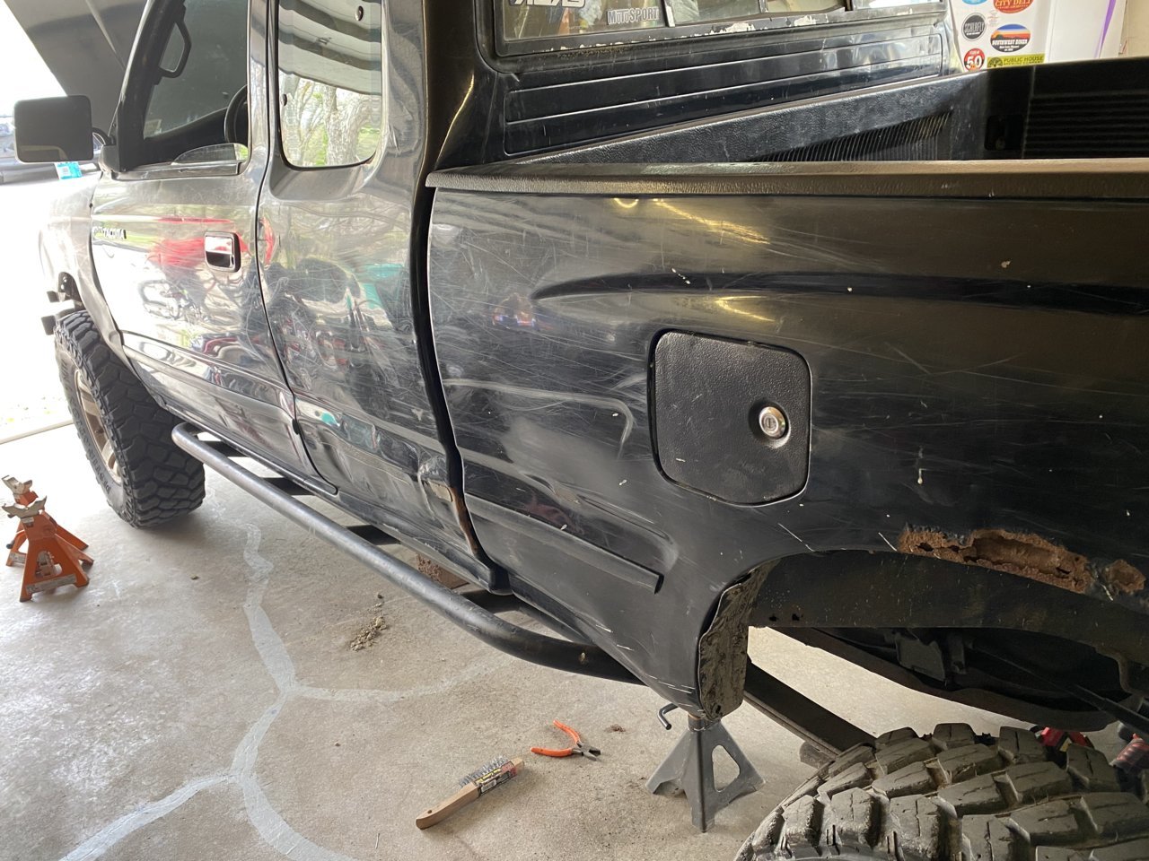

    I don’t know if this needs its own thread but here it is. May or may not be information in here that could help or not, you decide. I did a horrible job of documenting the process of these things but if you have questions, ask.
    So, I picked this up about 2 months ago now. Been needing a trail truck due to my 3rd gen still being down and waiting on parts- see 2018 Tacoma overlanderrrr
    Cons-
    220k on the clock
    31x10.5x15s
    Weird diy front bumper
    Rusted to hell
    Dirty asf, smells like garbage
    Beat to poo
    Poorly maintained
    Probably unsafe for the road
    Pros-
    96 extended cab 4x4
    4cylinder 3rz
    Manual trans and hubs
    Not stolen, have title in my name now
    Will get a lot of tlc
    No ac
    Window cranks are vice grips

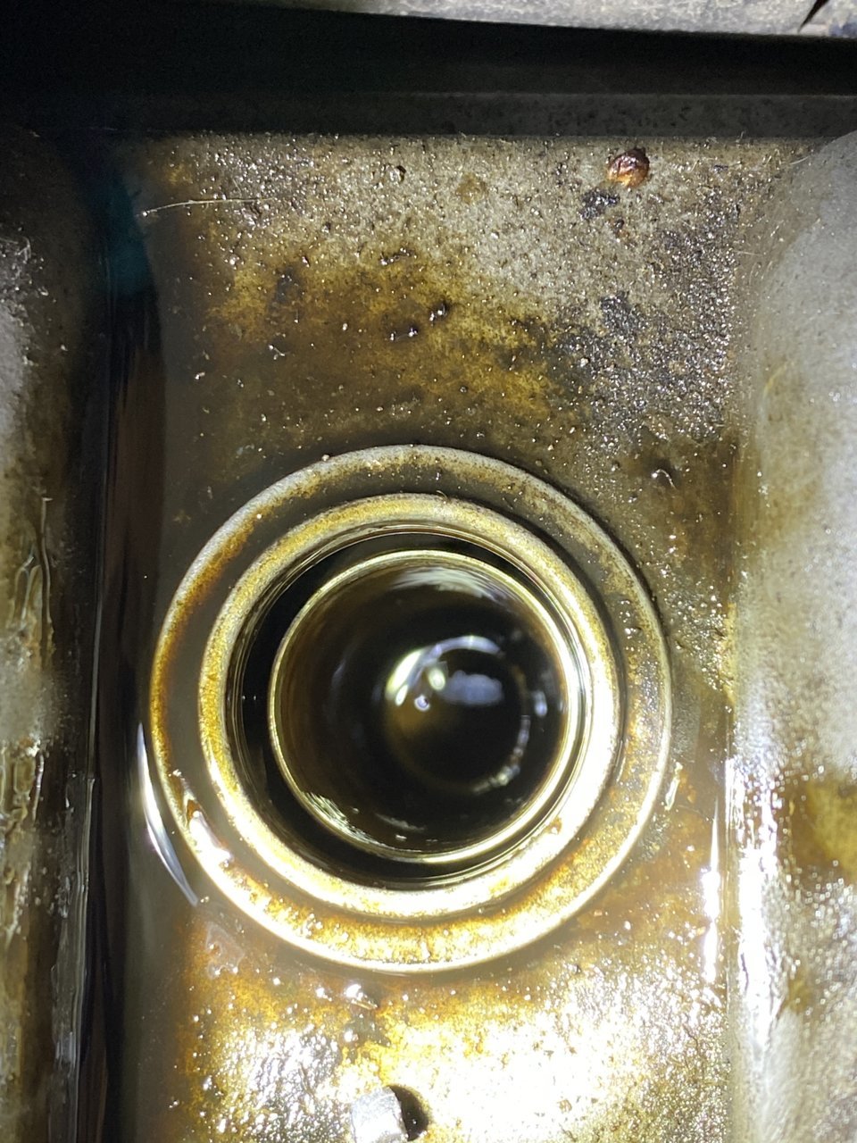

    Onto the first adventure, adjusting clutch to get it to actually grab before the firewall.
    Removed old fluid from reservoir
    Cycled new into it
    Adjusted the back of the clutch a bit
    Fresh fluid
    Wayy better than it was before.

    Maintenance-
    -Replaced passenger cv due to boot failure and rust
    -Replaced passenger side shock mount at frame, due to rust. Welded in a new one
    -replaced plugs and wire with new. Plugs all looked terrible, wires were decent but #1 lead was broken off at the distributor. Plug hole 3 and 4 were coated with oil, 4 being filled up about half way. (Valve cover gaskets and seals needed)

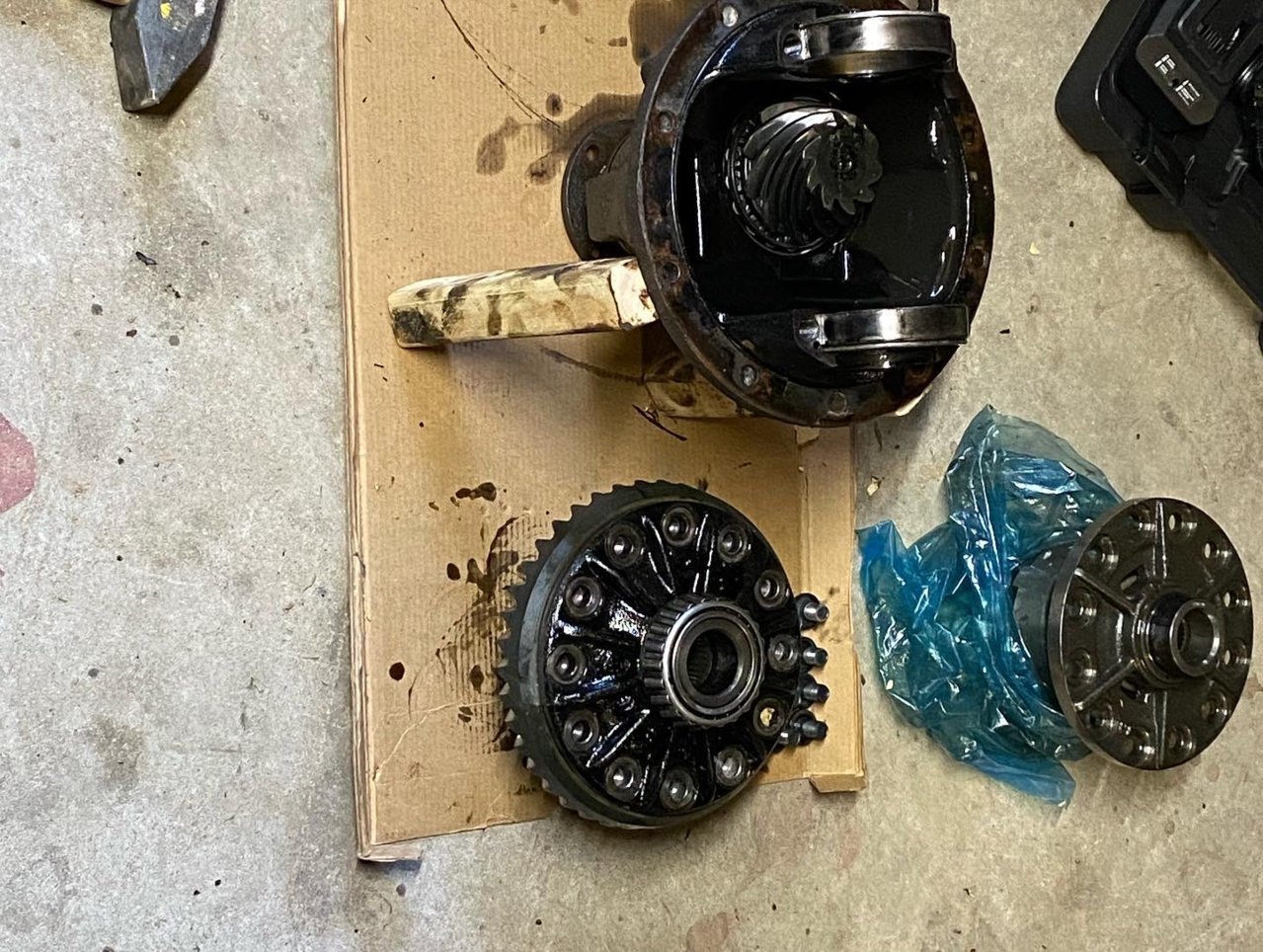

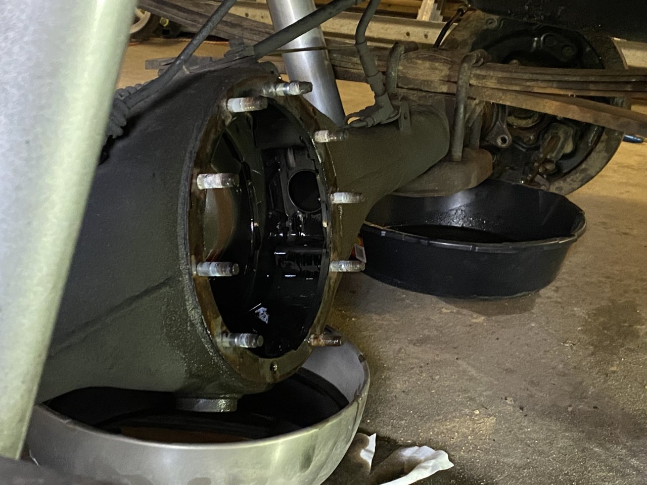

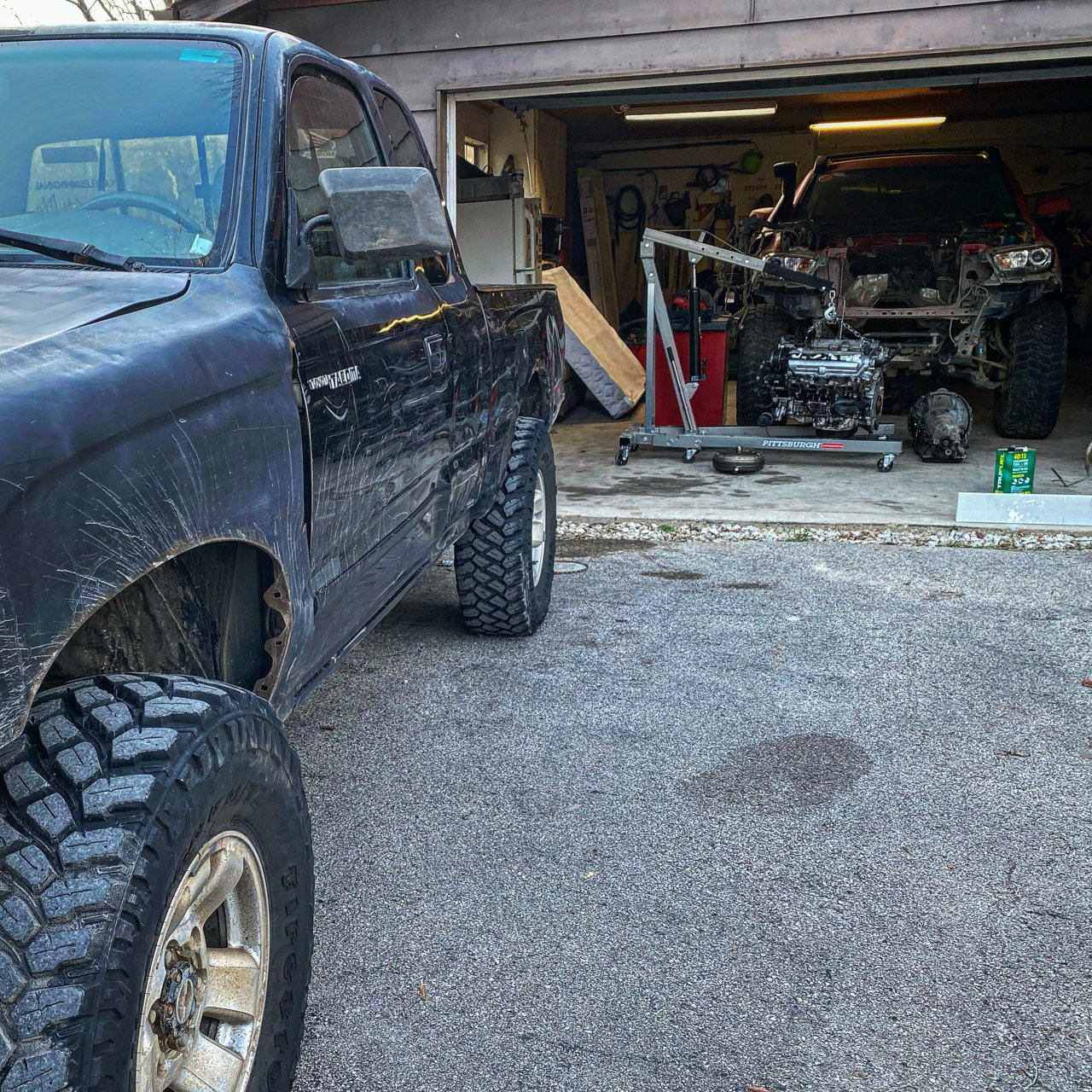

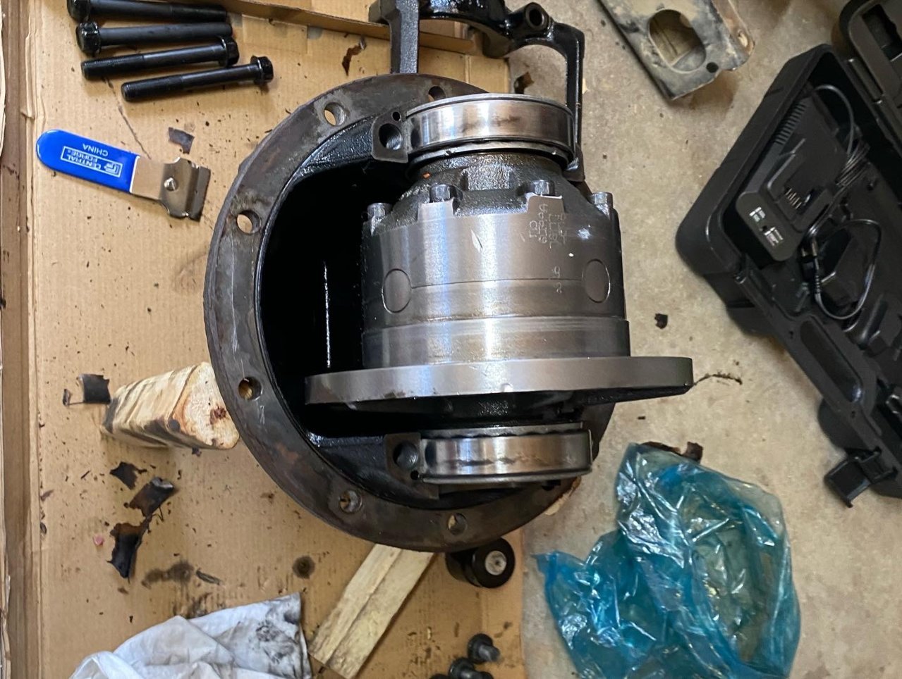

    Needed a rear locker something fierce
    snagged a detriot locker off eBay for $250. Barely used.
    -remove driveshaft
    -remove 4 bolts from each hub on rear
    -loosen parking brake cables from drums
    -slide axles out
    -remove 3rd member from axle
    -remove diff
    -remove bearings (I reused them, just cause)
    -remove ring gear
    -install bearings on detriot locker
    -install removed ring gear
    -reinstall diff in 3rd member
    -clean and apply new gasket to axle
    -slide 3rd member back on
    -slide axles back in
    -bolt everything back together
    *torque everything. *1 ugga dugga= 40lbs, 2 ugga dugga = 80lbs
    - test drive. If nothing clanks/ vibrates/ falls off, you’re probably good to go. But make sure to fill the diff back up with fluids before driving
    Chevy 63 swap-
    You can ask questions about this, too much to list. Take your time, measure 8 times. Tack weld/ check fitment and clearances before burning it all the way in.
    I grabbed a set of junkyard 2010 1500 leafs. 2+1. (2 and overload) total cost- $34
    Used the kit from low range, purchased from jegs. $250 and it was a breeze with their parts
    Extended brake line- must have. Ordered from headstrong. Think it was a 22 or 27”?
    Shocks- ones I swapped in, worked just fine. Rough country 0-5.5” lift $100 for the pair
    Rear end was jacked up about 6”. Shackle angles are about 40* at ride height. It’s set right where I wanted it, you can adjust yours how you want. Flexed out completely, the shocks were fine, bumps wouldn’t hit, so they need to be made to sit higher.
    Front end-
    With the rear coming up so high I wanted to see what I could get done on the front, quick.
    Ordered a set of replacement struts and a 3” level set. I know it’s cheap it’s coming off again within months, soon as I find an axle.
    That didn’t help, only gained about 1/2-3/4” from the old worn out struts and level. Oh well it’s smoother for the time being.
    Armor-
    Threw on a set of sliders I found on marketplace for $175. Don’t know what they came off of but they were just about long enough, if not perfect. Welded them right on to the frame.

    As I do more to the truck I will probably post it, don’t count on it though.
    As of right now I know it needs-
    -Drivers cv, torn boot and rusted internals (not slinging grease yet though
    -Drivers side rack boot (already have just haven’t installed yet)
    -Antenna. Have this as well but haven’t gotten the broken stud out yet. Radio sucks without it
    -Valve cover gasket and seals
    -Rear brakes- rusty and crusty
    -Radiator- 2” literal hole in it, from what I assume was a tree branch. Doesn’t leak or overheat so it’s staying for a bit. Must focus on the important stuffs
    -Tires- these could be decent but it needs 35s. IMHO
    -Front locker- lunchbox is the plan. This is more of a trail truck, definitely not a daily. It just going to be going to the trails on the roads
    -Bed Bob- just cause
    -Solid axle- to fix the lift in the rear issue. Gonna just do leafs for this. Trying to find a wagoner axle to do it with. Patiently waiting for one to pop up.
    -Front bumper. Gonna find someone with a tube bender or I’ll get one my self and bend up some sort of stinger one with winch mount. Would like to match the 3rd gens. ***cough cough**
    -Wheel bearings in the front. They are shot. A good 1/2” play on the drivers wheel.
    -Paint job? I’ve got 2 gallons of plasti dip, might just hit it with that and call it good. I do have the whole setup already, the sprayer and all.

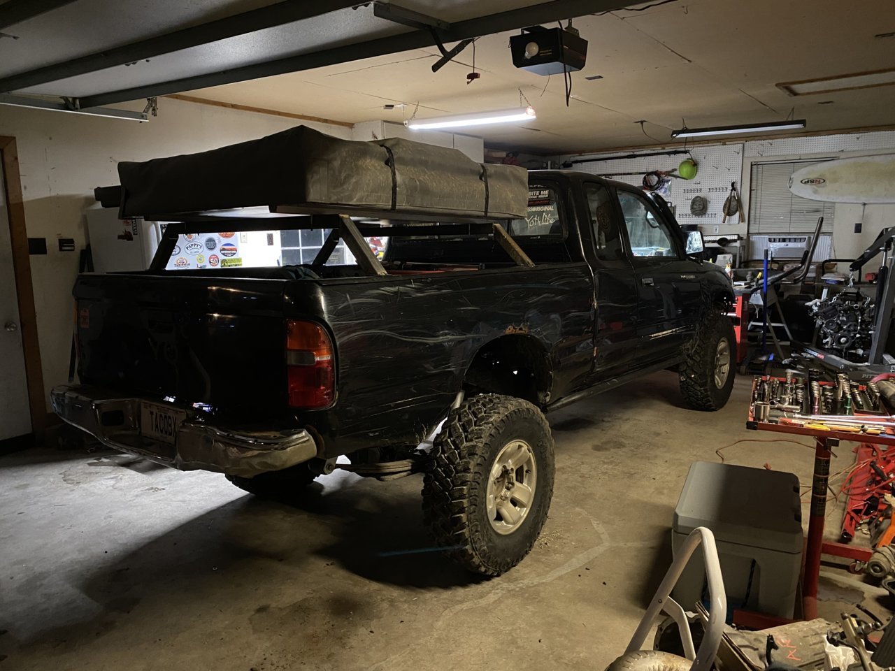

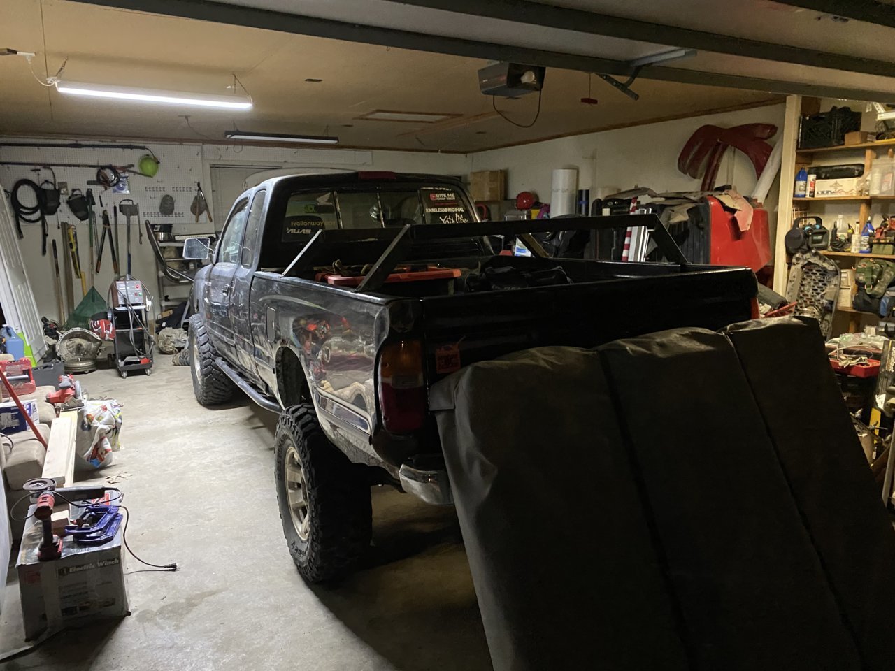

    Made a very crude bed rack to hold the rtt. Ran out of steel, almost melted the side of the bedliner but it’ll be ok.
    Have to remove the whole thing and finish weld it all. Rattle can it all and throw it back on.

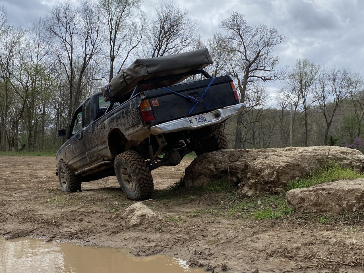

    Can’t really say anything bad about how the truck performed this weekend. Rear locker helped a ton. The 63 swap is well worth it.
    just need to figure out the clutch. Thinking it maybe the master. Hard as heck to get into gear now, wants to grind if it does and reverse just doesn’t go in. Have to turn the truck off, put in reverse then start it with the clutch in to get it to go into reverse. Not fun. This was sort of an issue before the trip but I’ll look into it this week.
