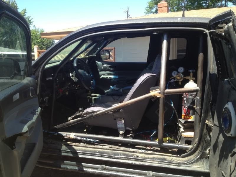

    You could just do spacers like you said, or a few thick washers. The bolts are pretty long, might even be able to re use them, but in a crash they might rip out. If you get longer ones get the same grade bolt that is in there. I raised mine about an inch, but it's probably a little more involved than what you are thinking.
