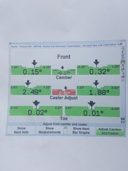

    How's it ride? Caster seems a little low, especially the right side. Did you do the lifetime or the onetime?

    Alignment techs be like it's in the green :notsure: fuck off!

    Rides fine. I did the one time thing.

    All it is, is caster. Wheels/tires are far forward that's all. You will be fine. Your camber read is the one to worry the most about.

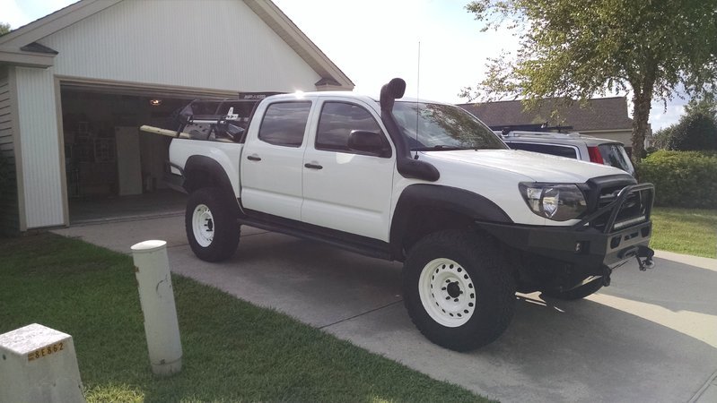

    Me and the truck aren't friends today after finishing snorkel

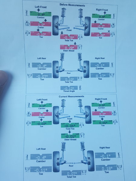

    Yes I just put LR UCAs on recently. Last time I went before today, the guy from firestone couldn't get my caster up any higher with my old stock UCAs. This was the printout with stock:
