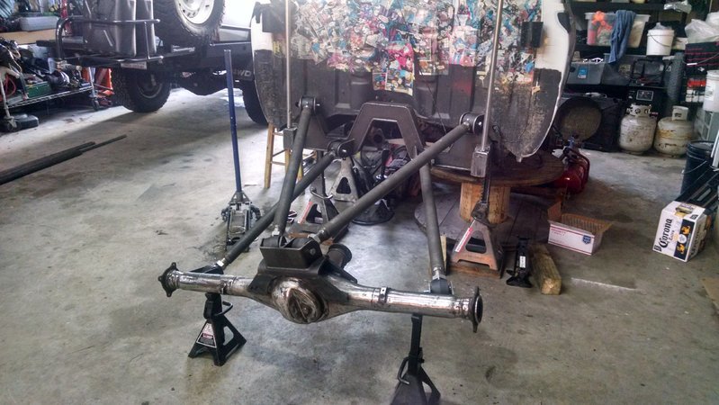

    Theirs progress

    Oh after looking harder, I see the wonderful ring teeth

    Did you build that. That's too cool.
    Never mind. Found the thread. It's even cooler that you built it.

    now rebuilding it.
