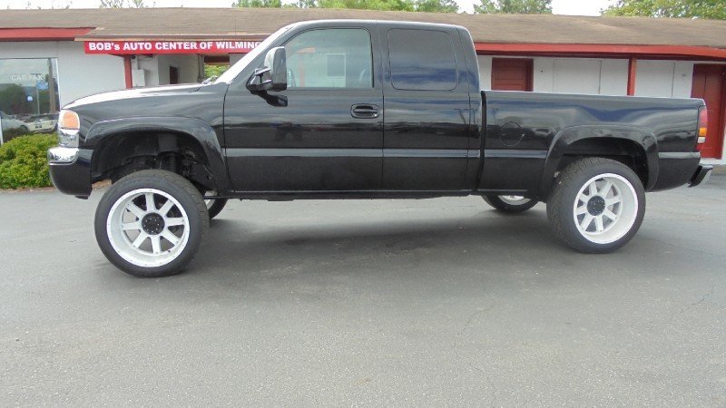

    In Good ol Wilm, nothing but glamour jeeps and squatting Chevs and fords.

    You can even buy them pre-squatted from dealerships

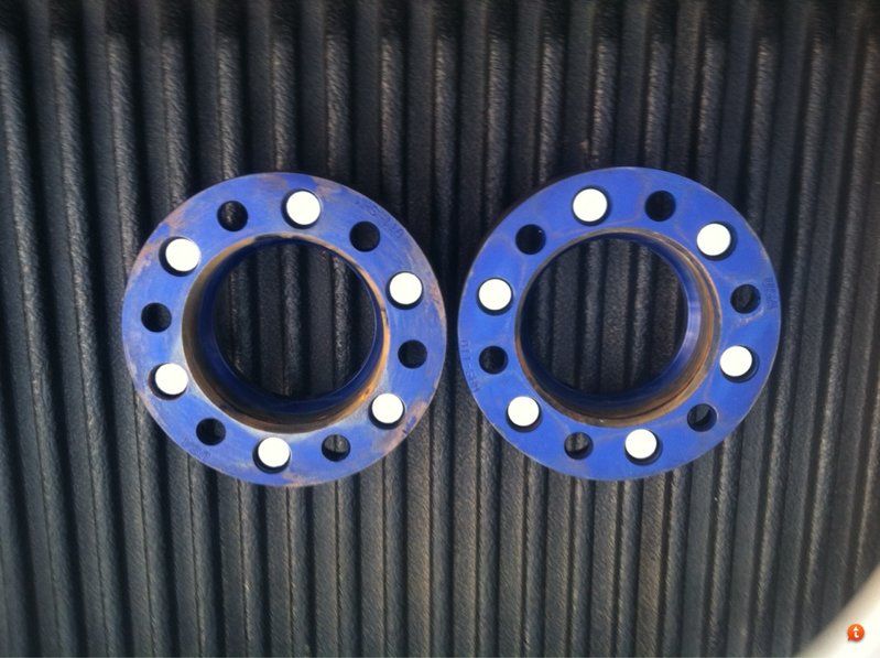

    got my wheel spacers today - going to go buy a torque wrench this afternoon. Hoping to install tonight or tomorrow. Any advice/tips for putting them on? Special setting for the torque wrench? (I have only used 1 once before)...
    I'm 100% convinced I am going to drive off with 3 wheels or have one fly off while in route somewhere...
    Anything you can tell me to ease my concerns would be really appreciated :fingerscrossed:

    Believe it's 75 lbs. I'm running them in the rear

    use antisieze, saw some ones that had to be beat off so hard that it made them not usable. My spdertrax were 85ft-lbs for spacers and 75-85 ft-lb wheels (from there instruction sheet) tighten in criss-cross pattern

    Where do you spray? On the bolt then put the nut on? or on the nut after its on the bolt? Or...on the back of the spacer like glue?

    Its more like a paste that comes with a little brush. This is what i did (not saying its correct, but what i was told) brushed in on were its tapered to meet center of hub. in pic were its kinda rust looking

    sweet - thanks! Where can I buy that? I googled, Lowes and Home Depot have their own versions of it but i can't find the exact name you mentioned
