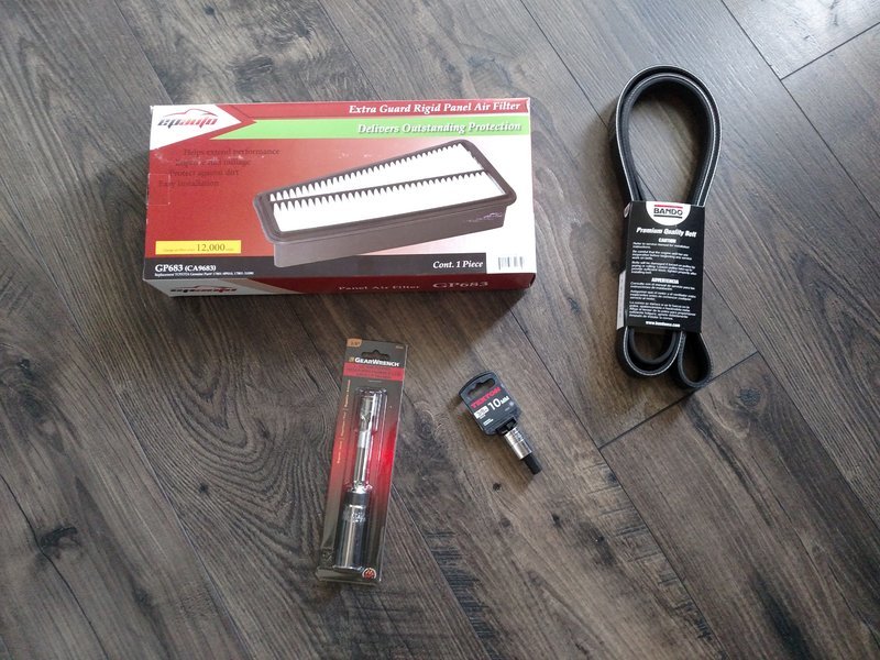

    Finally starting to get parts to do my 100,000 mile maintenance.
    Not sure what all I'm going to do but for now I plan on belt, filter, oil, plugs, diffs, thoroughly grease u joints, new battery and maybe get the trans flushed. Any other recommendations? Not sure when any of this was done by previous owners and I'm going to be spacing these all out a bit and start now until I hit 100,000 miles.

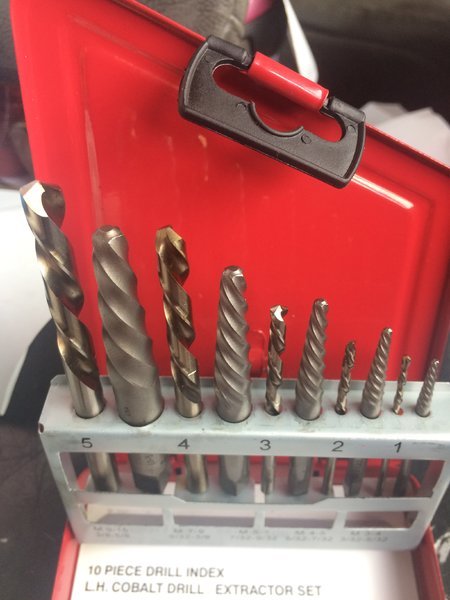

    There are a crap ton of opinions in this subject. I will tell you this.
    I change a lot of plugs in varying types of equipment, the only ones I've had issue with are ones where the previous installer just forced the plugs in or didn't use the correct plug. Some Mazda engines require a copper spacer to keep end of thread barrel from protruding into combustion chamber. If this isn't followed, carbon builds up on end of threads and they are a bitch to remove.
    I've yet to trash a head because of this but I gave spent a lot of time getting the plugs out.
    If a plug doesn't come out with minimum of force stop and evaluate why
  20. Apr 18, 2017 at 10:45 AM
    Blkvoodoo
    Blkvoodoo a Hooka smoking caterpillar has given me the call
    Jul 23, 2015
    #160098
    4,187
    Kevin
    Near Clayton NC
    08 PreRunner SR5 DCSB

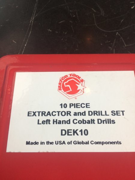

    I was present for one of those at a buddies shop last week. The porcelain blew out, the hex caved in when trying to extract.
    He tried multiple extractors from parts store, none would get a bite.
    I had literally just bought this kit as I use them often for my job.
    It was a make or break deal, owner standing there watching. SNAP !!
    We looked at each other, it either broke or broke loose.
    Fortunately the plug remnants broke loose and came out.
    $70 well spent! Didn't cost him a dime !
