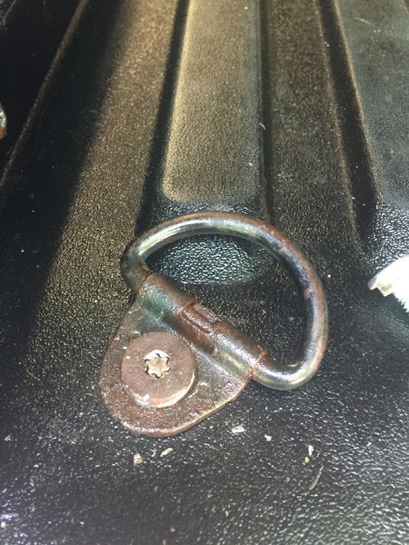

    Wish I would have seen this I struggled with a bolt for 2 days this weekend. The damn thing was basically fused with iron oxide. I had been spraying it for a couple of weeks with PB blaster because I knew it was gonna be a pain in the ass to bust loose.
    Ended up putting enough torque on it I snapped a torx socket
    The Solution was a vice grip and buying another torx socket that combo was the only thing that kept it from spinning.

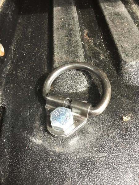

    New Fresh Dodge Sprinter D-rings that actually spin and move! Old ones were frozen in place.

    Congrats! Way to persist. I've got an impact screwdriver, may just hammer on mine just to make sure that they aren't frozen.
