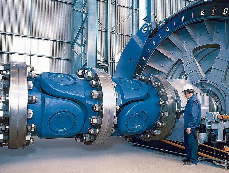

    I don't know how fast this thing turns, but it's amazing they need joints that close together.
  19. May 7, 2017 at 12:39 PM
    Blkvoodoo
    Blkvoodoo a Hooka smoking caterpillar has given me the call
    Jul 23, 2015
    #160098
    4,187
    Kevin
    Near Clayton NC
    08 PreRunner SR5 DCSB
    It could only be because of vibration and the isolation of main structures from the bed the machine rests on.
