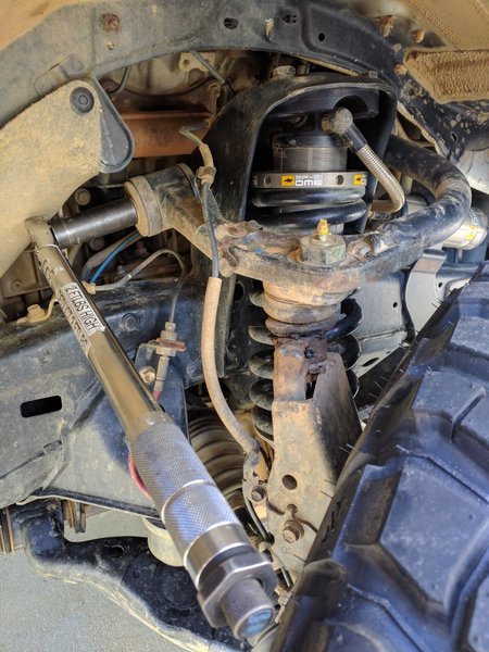

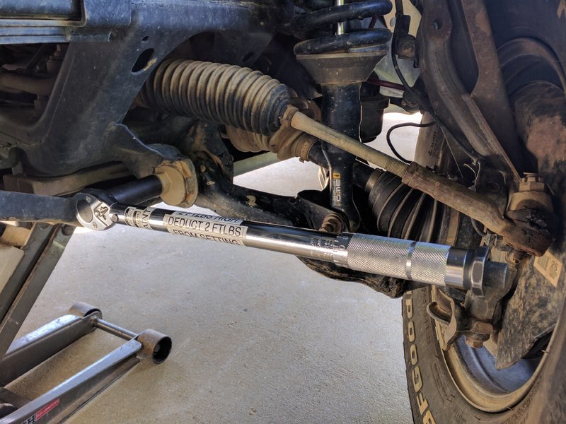

    Derek

    So, you have calibrated your HF torque wrench? Since I always click, nudge go back and click I know that if I were within 2lbs I'd be surprised.
    You got to admit you can't beat them for 10$ on sale.

    I know a guy :D. Honestly was surprised to see that it was only 2ft/lb off, completely happy with the "investment". Now DO NOT take this to mean they are all that close... They are made in China after all.

    Friend of mine bought 10 HF torque wrenches on Gov't contract and had all but 2 certified per FAA requirements for the job he was on (UPS and back up generator work @ various airports), gave the company that does the certification fits when he sent them "junk". they were able to certify 8, thats not terrible......

    No it's not. and considering the graduations on the handle are so faded I'd have to be wearing my reading glasses to even use a certified one.
    I understand their digital torque adapter is crazy accurate though. I picked one up for $19 and was able to check it against my torque wrench. If the digital one is accurate then my wrench is 2 or 3 off at 50lbs. too.
