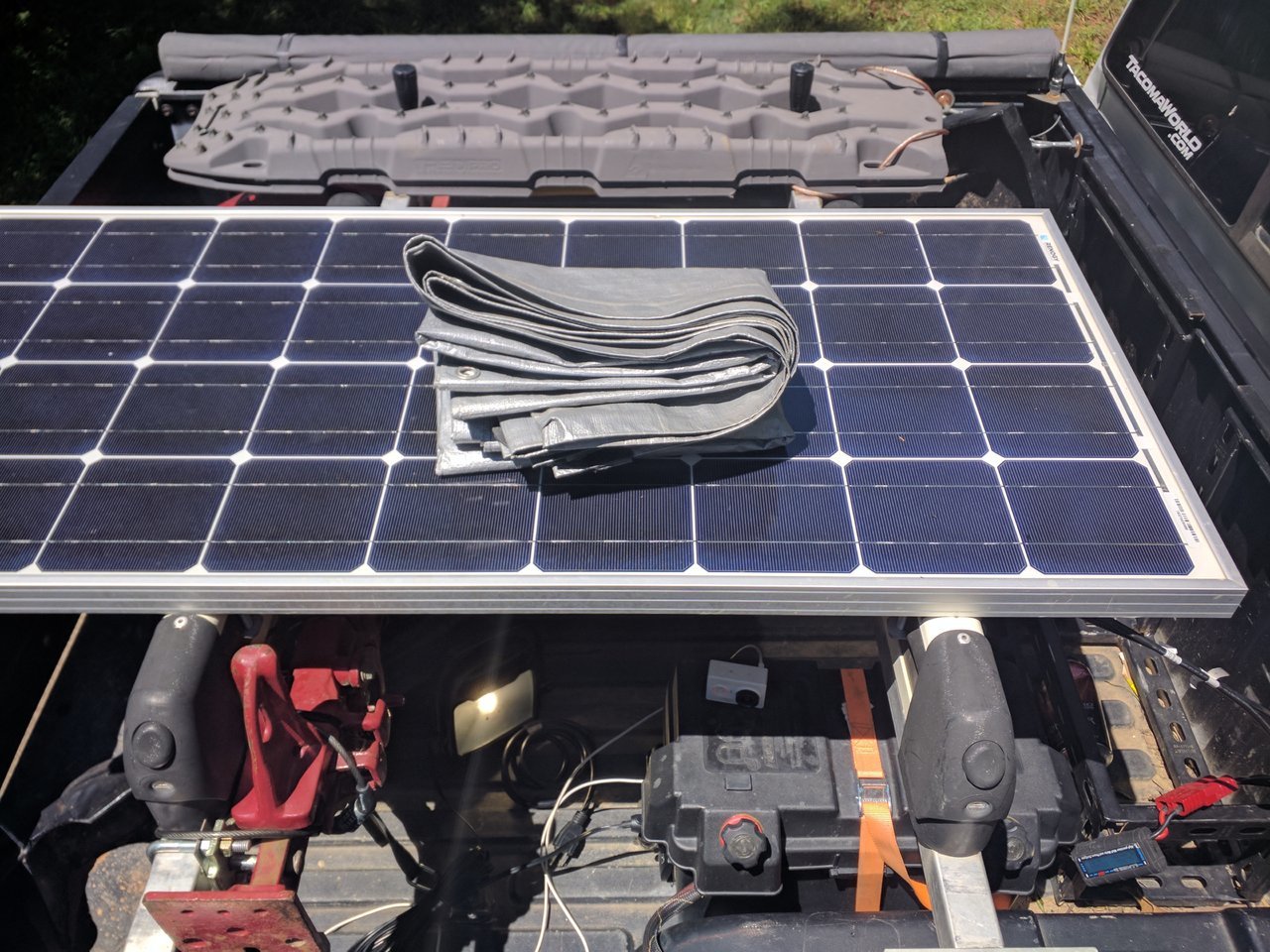

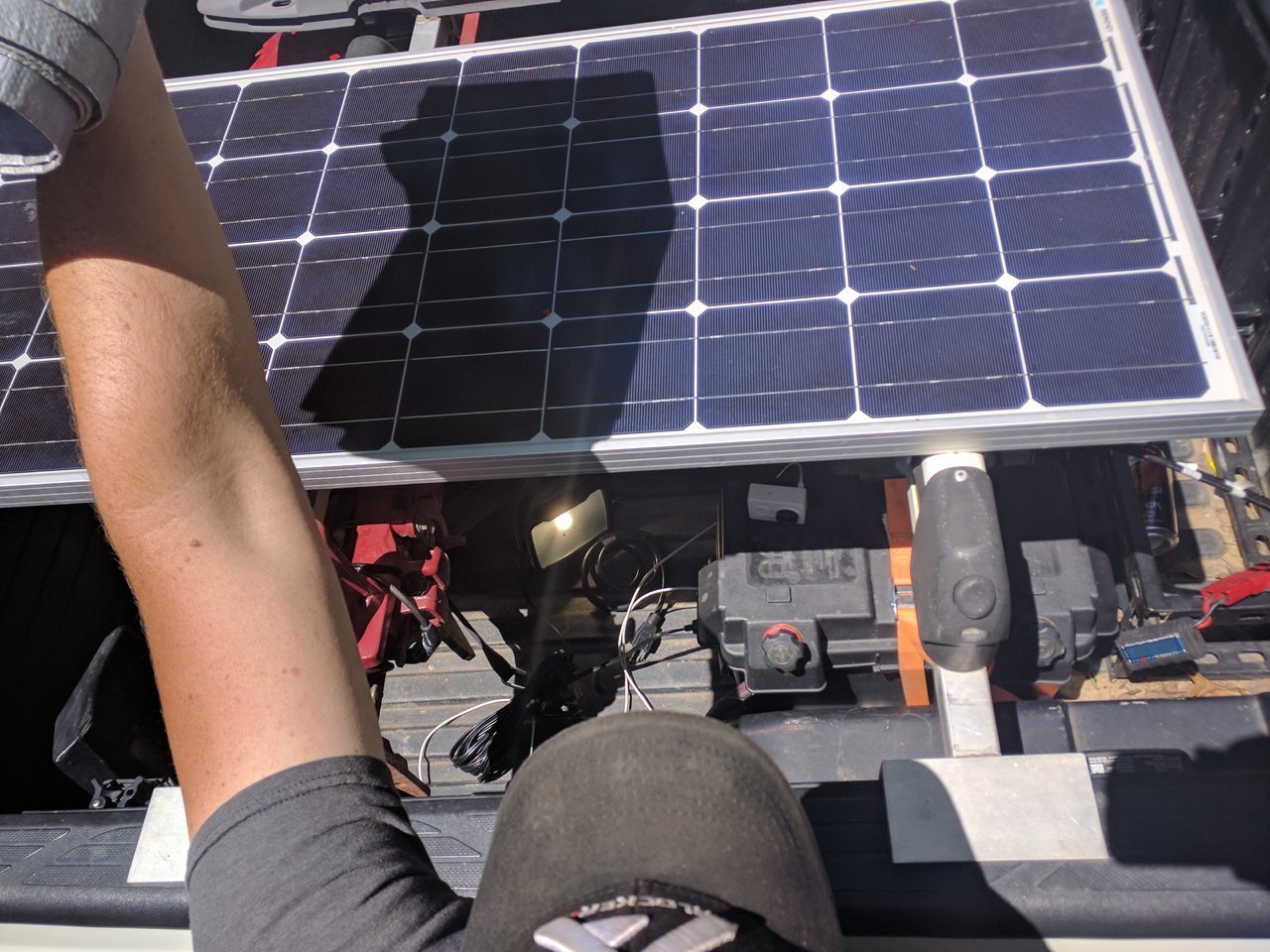

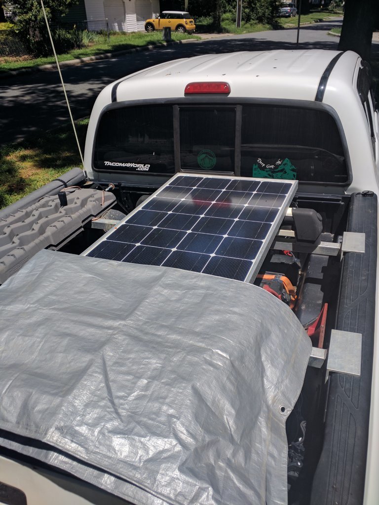

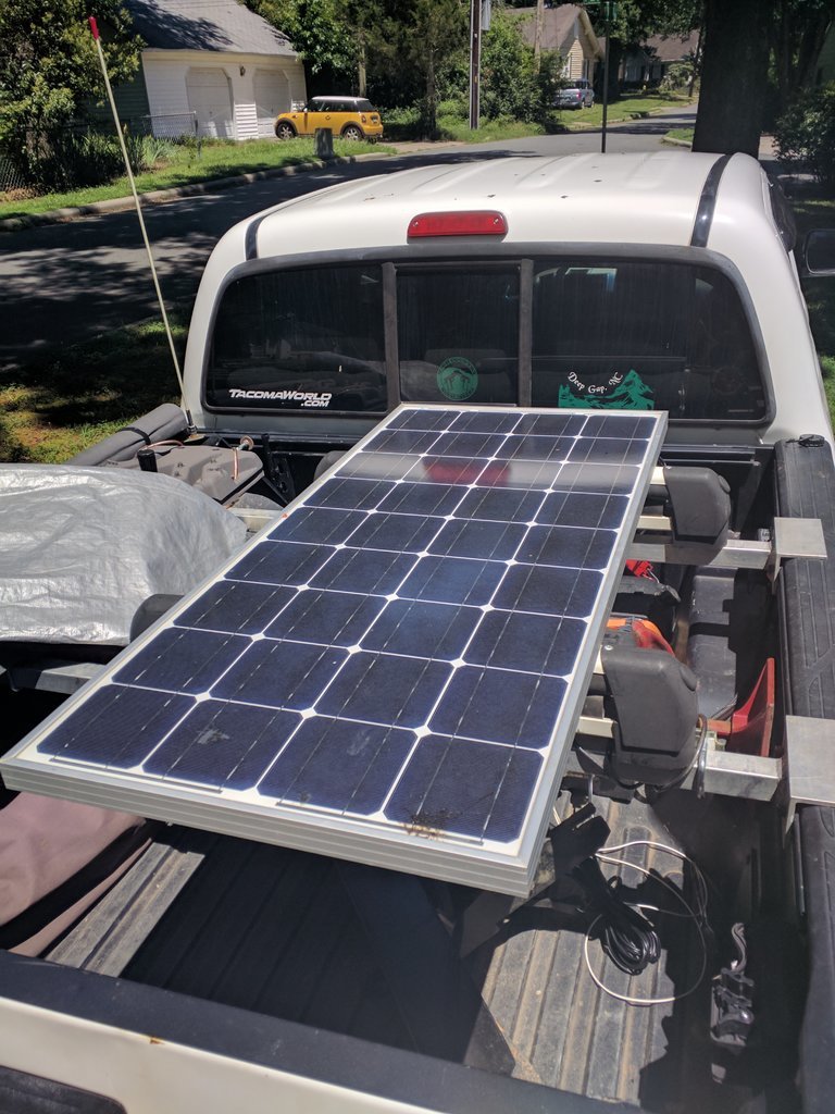

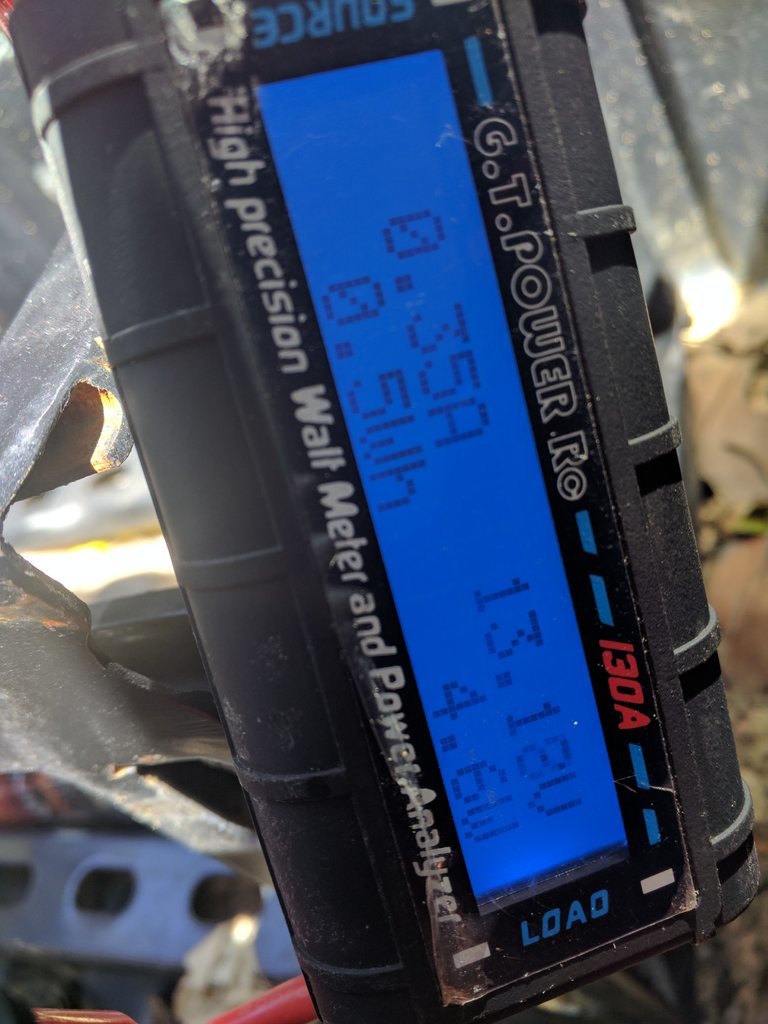

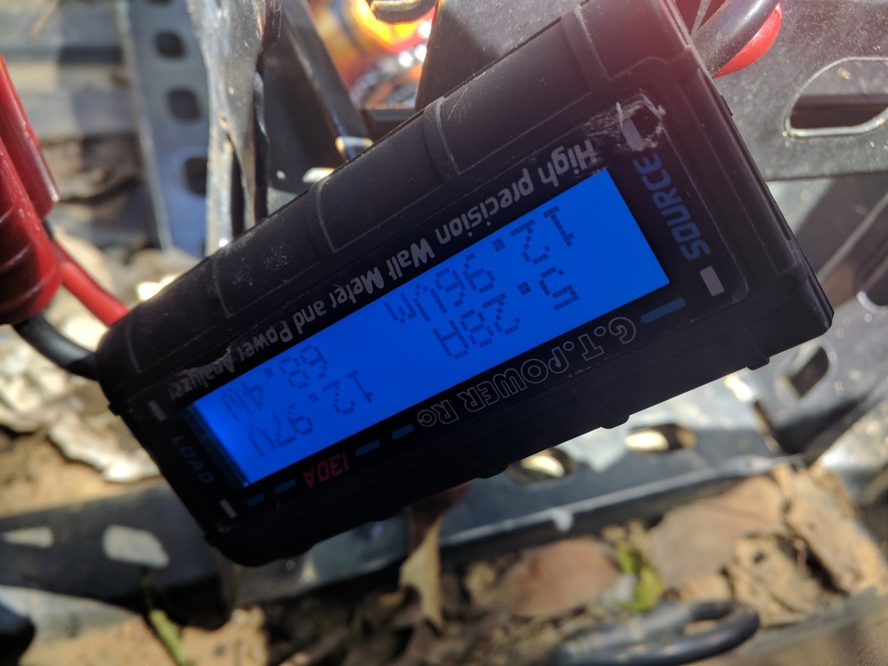

    If anyone is interested in solar panels and shading. The argument was a shaded panel doesn't produce ANY power. I should probably test with the meter inline with the charge controller and battery.
    Panel: Renogy 100watt monocrystaline, pwm charge controller

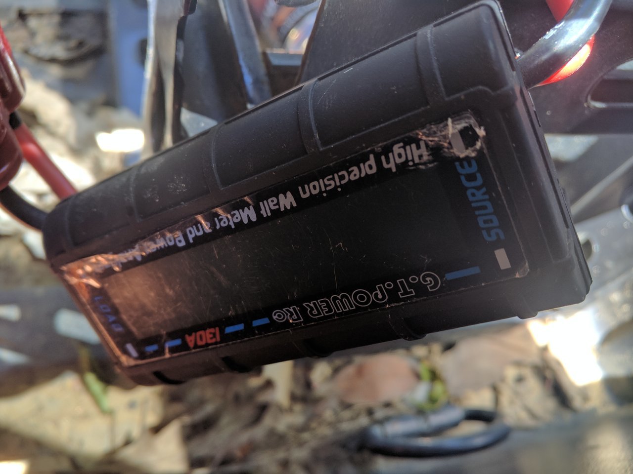

    Meter: G.T Power Rc meter inline between solar panel and charge controller
    Load: Fully charged house and starting battery. Starting battery load of Ignition turned to On position with radio, fan, and headlights on, House battery load of a "go pro" and 12v led work light.
    Test 0: Full sun
    Result: 12.97v, 5.28a
    Test 1: Partially shade panel (~20%)
    Result: 13.18v, 0.35a

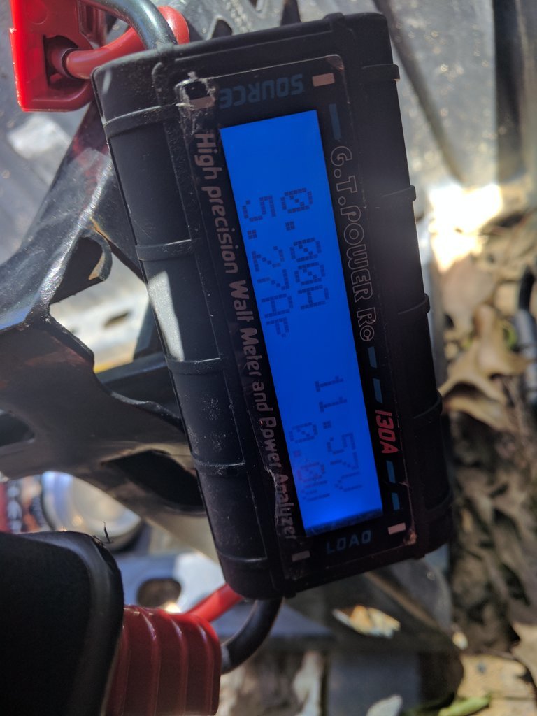

    Test 2: Fully cover panel (~15%)
    Result: 11.57v, 0.00a voltage changed with different positions of tarp but no current was recorded.
    Test 3: Fully cover panel (~30, 60, 90%) and check output amperage/voltage
    Result: no reading, I changed the position of the tarp which made little difference. Sometimes the meter would light up but not have enough power to function.
    Conclusion:
    A fully covered (percentage) panel will not produce enough voltage/current to power a device or charge a battery.
    A partially shaded panel will produce voltage but may not produce enough current to power a device or charge a battery.
