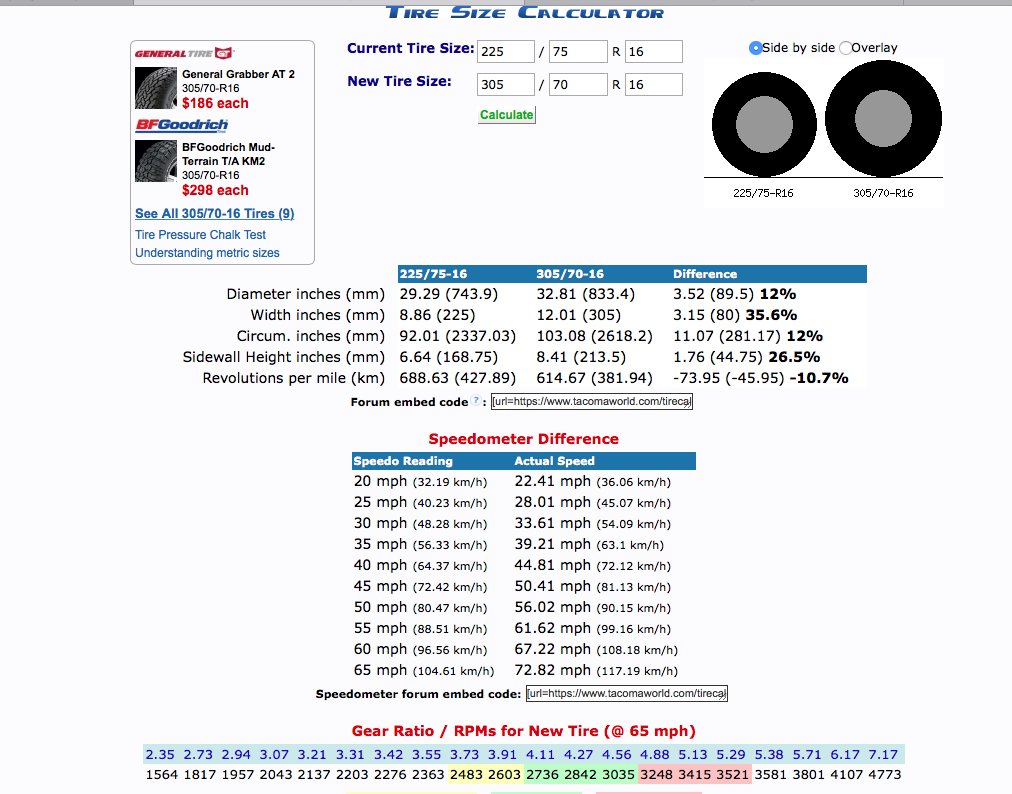

    Blkvoodoo
    Blkvoodoo a Hooka smoking caterpillar has given me the call
    Jul 23, 2015
    #160098
    4,187
    Kevin
    Near Clayton NC
    08 PreRunner SR5 DCSB
    it effects both, tire roll out, a taller tire covers more distance per revolution, if the speedo isn't celebrated for the roll out your speed is actually faster at indicated speed as each revolution goes further
    your 4.10:1 ratio is the same, 4.1 revolutions of drive shaft for each revolution of the axle/wheel/tire the speedo doesn't see the change unless the calibration for tire size has been made in the ECM or in older vehicle by changing the drive gear on trans.
    https://www.tacomaworld.com/tirecalc?tires=225-75r16-305-70r16 a tire size calculator will show you this
    cbannister83 and Zwjense[QUOTED] like this.
  19. Jul 20, 2017 at 8:15 PM
    Dangerdave
    Dangerdave Official TW jeep representative
    Feb 12, 2014
    #122932
    8,295
    David
    Wilmington, NC
    20 F150
    Those tire numbers are actually from my post not his.
    So you're right but as far as mileage is concerned (the original question) it doesn't get better with larger tires.
    Yes it effects a lot of things. Honestly my speedo is so off I use my phone when on the highway just to be safe.
