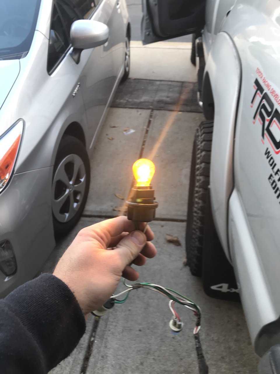

    Ok so back to the lights...
    It’s the housing. Right light works fine plugged into the left side and left light doesn’t work plugged into the right...
    Next step? Coke can? o_O

    Unplug all the plugs and look for corrosion. If there is corrosion the best way to get rid of it without some really tiny scrapers etc. is a coke. If there is no corrosion unplug the bulb socket and just switch the bulb sockets and check just that. What we are tying to do is eliminate all the different possibilities to pin point the problem and not end up buying a bunch of extra crap you don't need.

    It’s alive!
    I didn’t see any corrosion by I went ahead and dumped some coke in the socket for the bulb and also the male end of the entire wire harness, which is what seemed to do the trick because it still didn’t work after I cleaned the socket by itself :notsure:
    Maybe it was dumb luck. Maybe it was the coke. Maybe it will stop working as soon as I drive it again.

    Good. From experience the main issue with these sub harness headlights taillights etc is corrosion either in the sockets and/or the connectors. Glad it's working and just be glad you don't have a German vehicle where the subharness is somewhat of a printed circuit where the bulb sockets are built in and the circuit paths like to burn in half when to much corrosion builds up in the bulb sockets.
