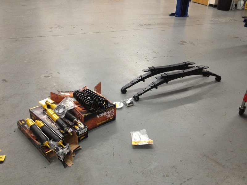

    All depends on budget, which lift really. I did spacer/level kit when I got my 08, but last year I did a complete 3" OME lift. The level kit was initially to clear bigger tires. But went to the OME when adding all extra weight of bumpers and such

    I like it alot. I wheel but not crazy (have another truck for tearing up). I didn't have the bank for LT or anything crazy, but im happy with the OME. Its one on those companys that been around for ever, and they dont seem to jump on any band wagons, no fancy bells or whistles. Just solid lift, my 2 cents

    And its something they can easily do on a mod day. Me and one buddy did mine took good part of a day

    Just know what doing with truck in the future, i knew was doing bumpers, so I used the HD springs with top spacer. The only thing that stunk was I was unable to get by with out A-arms my truck just maxed it out to much (may have been OK for street use). I read it seemed 50/50 for people needing to do A-arms. I used light racing A-arms
