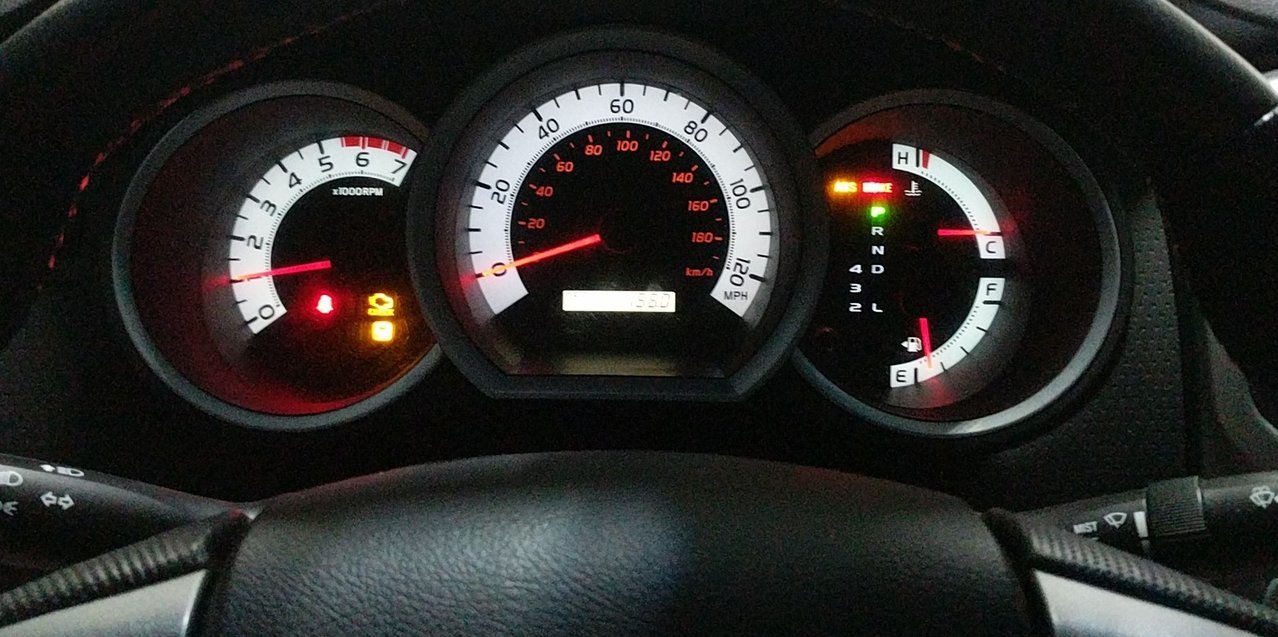

    Ign 1 No2 fuse strikes again. I don't know what makes that damn thing pop but it'll turn your dash into a Christmas tree and kill the windows, drl, fan, speedo, radio, etc. @T4RH33L

    She's a devious bitch.

    Last time I popped that one was when I was wiring the abs kill switch. Accidental grounded the wrong wire

    Same here. This one was after a bumper install and moving raptor lights tied to DRL.
