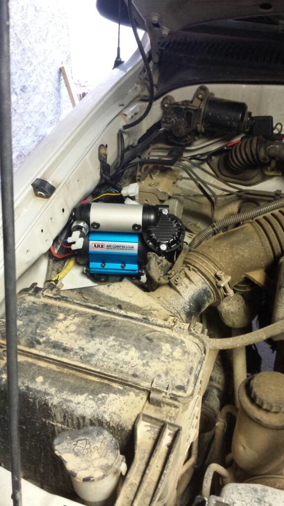

    If you dont ask questions.. you never know the answer. But yeah.. it will run both lockers and air up my tires at the end of the trip.. Eddy has the same one and runs his front locker off it and fills his 35s.. from 18psi back to 35-40.. don't know what he runs.
    Almost got the dual compressor but the main purpose of that one is the deep cycle pattern.. for running air tools. Other than that the one I got will be perfect for what I need.

    Looks like a pretty good compressor...

    Drained my 33 to 15psi and filled it back up to 32 in about 2 minutes

    Lockers don't work on flow so you can get away with a small compressor for them, or dual use. The cycle rate is a key factor for filling tires. You don't want a long cool down time for filling. That smittybilt one I use can run both the Lockers and fill tires,at the same time if you have a tank for the Lockers ;). I need a tank.
