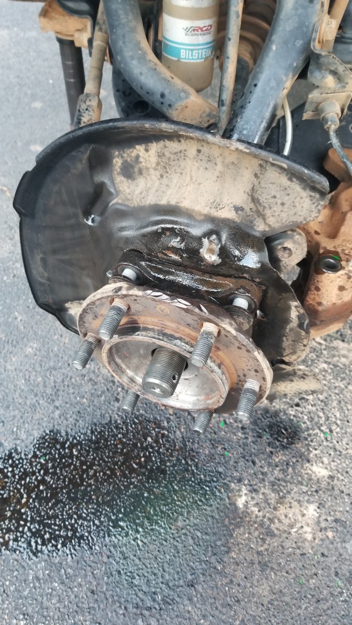

    Here tall go. If anyone is willing to come help let me know I'm currently beating the hell out of it

    Doesn't look rusted/seized to me. Beating the hell out of it probably is overkill. Tap it at the top, then the bottom, then the side, then the other side, rinse and repeat. Work it around and out it comes. Could even get a screwdriver/prybar in the opening and pry it a little, moving around in the same fashion as tapping it with the hammer.
    What's the green stuff splashed around?

    Came out the hub after I sprayed it with PB blaster. All I have is a roofing hammer with me so
