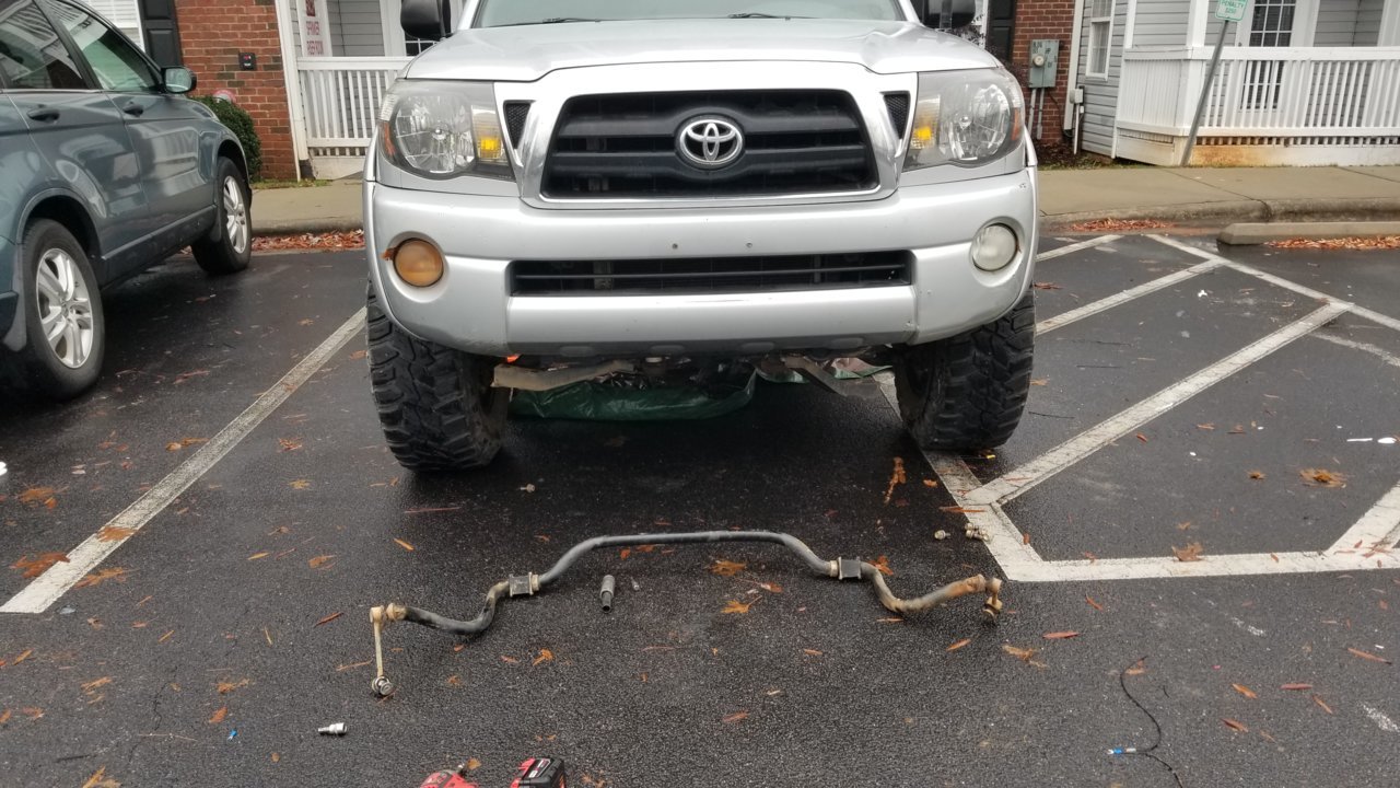

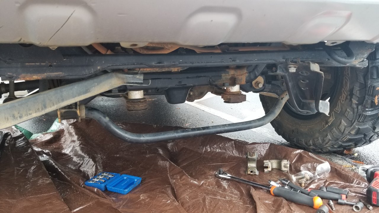

  13. Dec 15, 2018 at 10:20 AM
    overlandozzy1
    overlandozzy1 Well-Known Member
    Oct 3, 2017
    #231929
    821
    Jonathan
    2016 WHITE DCLB
    16 DCLB, ADS, 5.29s, 35s, RCI Skids, Baja Designs
    Sway bar removal time. The end links are a bitch. Debating on cutting them off

  14. Dec 15, 2018 at 10:49 AM
    Sandman614
    Sandman614 [OP] Ex-Snarky TWSS elf, Travis #hotsavannahdotcom
    Oct 26, 2010
    #45273
    36,067
    Tim
    Garner, NC/Boone, NC
    '06 SR5 Off Road
    Dude it's just bolts. Grab the one end with a pair of vice grips.
    ovrlndkull and Dangerdave like this.

  16. Dec 15, 2018 at 11:06 AM
    YamaDirtrider
    YamaDirtrider Custom bumpers @FORT-ifyRigs
    Mar 1, 2016
    #179877
    6,343
    Josh
    Elizabeth CO
    06 DCLB sport postrunner
    What hasn't been modified?
    o_O The factory end links have a hex inside the bolt to hold them.
    ovrlndkull likes this.

  19. Dec 15, 2018 at 12:57 PM
    Dangerdave
    Dangerdave Official TW jeep representative
    Feb 12, 2014
    #122932
    8,315
    David
    Wilmington, NC
    20 F150
    I think my truck drove better without the sway bar. I think you’ll be pleasantly surprised
    TaKoToy and ovrlndkull like this.
  20. Dec 15, 2018 at 12:58 PM
    overlandozzy1
    Oct 3, 2017
    #231929
    821
    Jonathan
    2016 WHITE DCLB
    I hope so. Do you really gain that much more flex up front?
