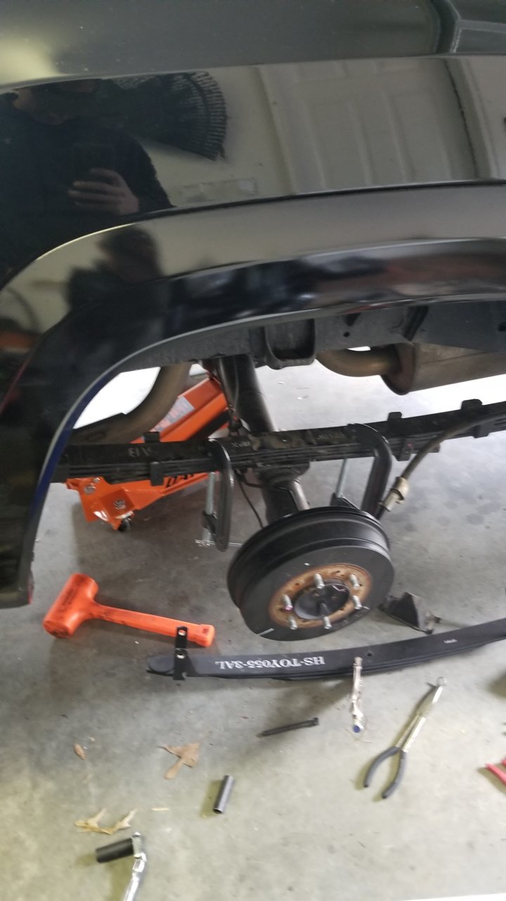

    So everything off one side of the rear and cant get the leads to seperate from the axle? Help?

    Have you let the jack down to let the axle fall??

    Yeah and they still wont seperate

    They wont come off the axle itself

    And you had the Frame itself supported? If you only have the axle lifted and lower it the springs will follow. The frame has to be supported.

    Sit the axle on jack stands on the lowest height. Jack the frame of the truck up separately. Something will have to give or get out the BFH!

    @overlandozzy1 These^^^^^^^^^^^^ and I'll add a BFPB as well.

    Please tell me you have the frame supported. If not, you may never hear the end of it. Brain farts happen though :rofl:
