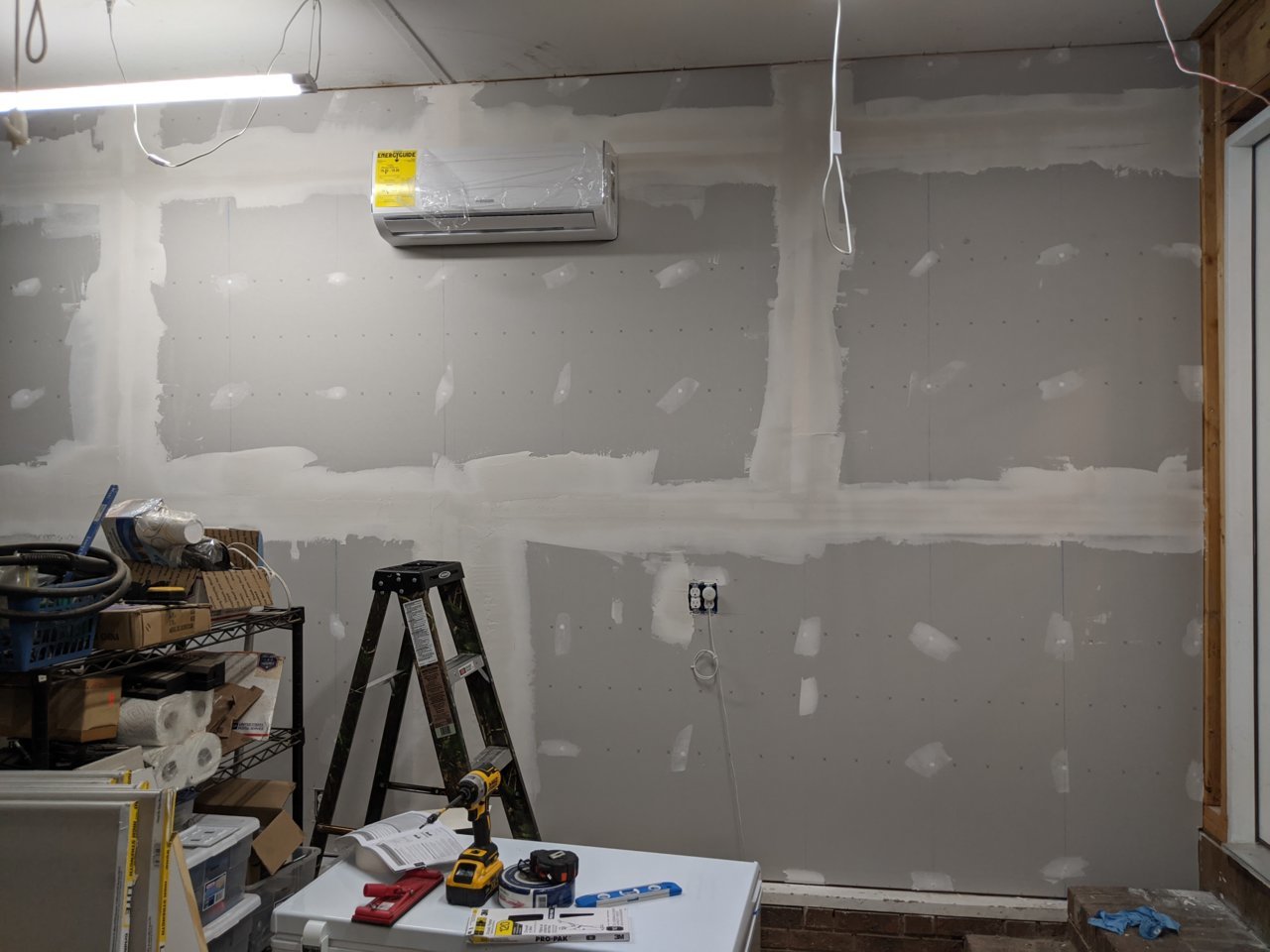

    Anyone know what there doing with drywall mud, and is good at it?

    What are you mudding? Just between sheets of drywall or patching holes?

    Well hell, it looks like you just about got it licked. Slap some Tape and mud on the rest of those seams and start sanding.
    paint covers up the imperfections pretty well

    :anonymous:those are stud lines :annoyed:its horrible

    Did you use joint tape ? and a nice 6” wide putty knife ?
    nonshrinking compound is also A plus....

    Oh it’s fine bro. Stop being a perfectionist
    seriously, I chased a seam for nearly two whole days at our office only to give up convinced it was going to look like shit for the paint to cover it up completely. I can’t even find the line anymore

    Also remember, most of that is going to end up as dust in your hair on the floor and in the vacuum

    Yea a 6" and 10 or 12, and watched enough YouTube videos to make me think I'm just an idiot.

    You aren’t, just inexperienced. And that’s ok, it’s not rocket surgery, it’s messy as hell and very trying on your patience.
    It looks like ass now, when you sand use a block, or a(cheap) power sander with a vacuum attachment. and the sanding screen in a fine mesh, then wipe with a damp cloth to finish. Let dry then prime it all. Remember, it’s a garage wall, not the TajMahal
    If your gonna be messing with it this weekend I can swing over
