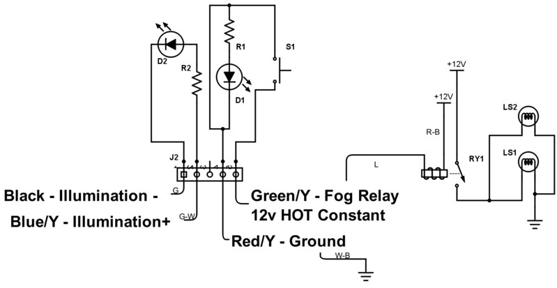

    Now if the relay can run on say 9V. then you could put a 3V zener diode from red to ground. This would allow the red pin to regulate at 3V but still pass whatever current the relay draws at the remaining voltage across it (approximately 9V). Then change the resistor on the LED to allow 20mA at 3V instead of 12V and it should work. 3V is plenty to light a small LED like that.

    Dangit, I knew that. I meant to put the led and resistor in parallel to the line going to the red wire. .

    LOL no.. you just have a wire across the LED and resistor... current will take the path of least resistance. you will get nothing through the LED. The way I mentioned above with the zener diode is the only way.

    haha I'm tired.. I need to stop diagraming while tired.
