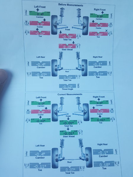

    I spy a toe and go.. Caster and camber changes very minimally probably from inaccuracies with the lighting and lasers.

    I'm gonna bring the truck to precision this weekend and I'll show him that sheet. I'll ask him if he thinks he can bring my caster up.

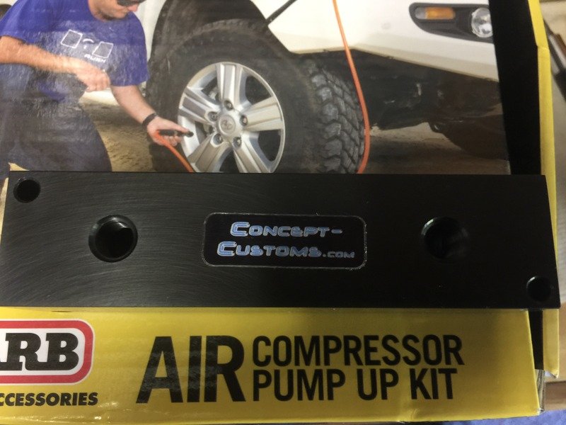

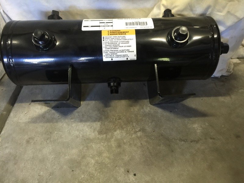

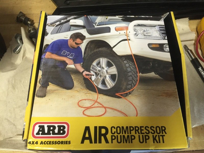

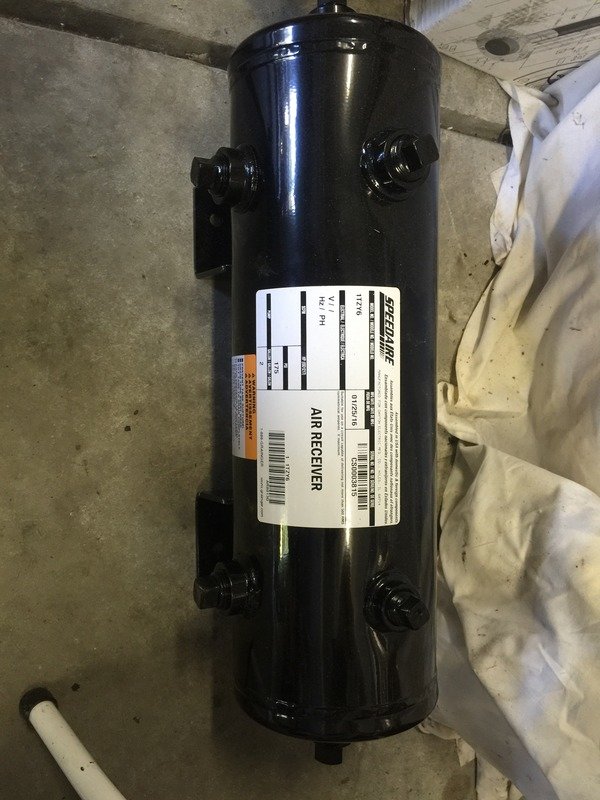

    Do you have the blue hose, normal air hose, solinoid, arb wire kit

    Si y no.
    How much and size of rubber hose?

    I think I used a 50' roll of goodyear 3/8 air hose for air lines, the blue hose is the crappy ARB hose (I run mine i rubber fuel line to protect it, and hide it) Fittings crap load of fittings. basically draw it out so can get idea of fittings you need, adapters 90 degrees, air chucks. thats the junk that adds up.

    Oh yea hose clamps, tephlon tape or paste (i like the paste other than i end up with it all over me)

    Mr. tire in Wakefield twice and the same Precision in heritage. Neither of them could get it with the stock arms :mad:
    Mr. Tire tried to tell me I had a bad tire that was causing me to pull one way. Dummies

    I have 1/4 (i think) id hose, fittings, chucks
    I have clamps & paste
    Is the black hose the 3/8 you speak of?
    So, you didn't use any of the blue arb hose?

    Hopefully someone here will chime in but I used the 3/8 for more air flow for airing up and such (may be nothing more at all). The blue hose is basically only used by ARB. If don't have any I may have some, or call ECGS

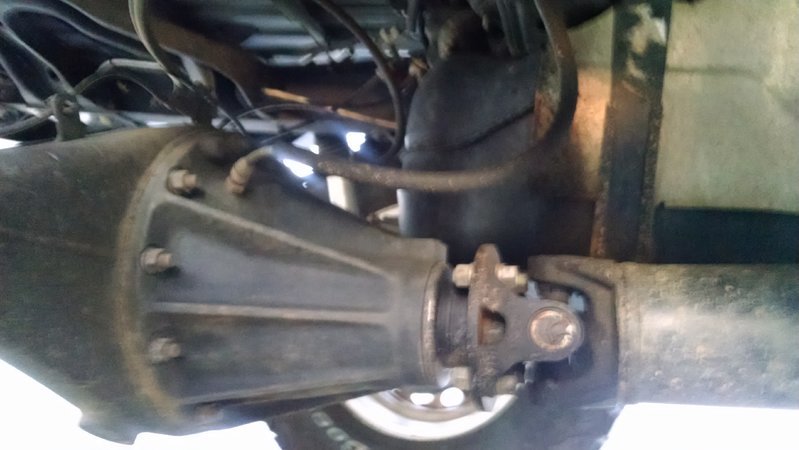

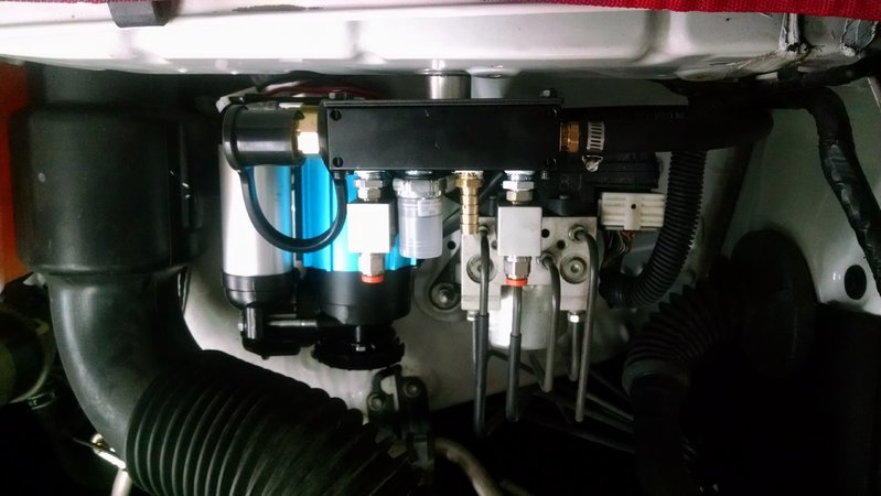

    Sorry just read the bottom again I ran all my blue arb hose in black hose to hide and protect

    @voz ran my arb hose in other hose as such
