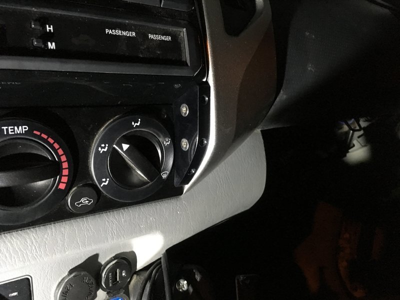

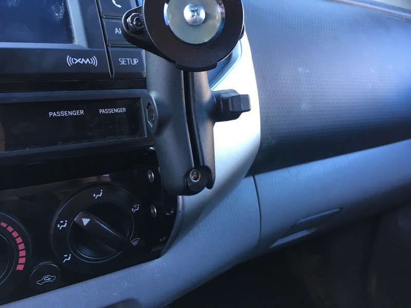

    First off, thanks to Jon for sharing this excellent and extremely well-executed design with us. He is the real deal and an excellent dude.
    Installation notes (passenger side only):
    Contrary to what I thought originally, there are no shortcuts to putting these in. I tried going through the glovebox (with it and the internal upper panel removed) and discovered that there is no way to get the adhesive-backed plate in position that way even with the new holes pre-drilled in-place in the truck. Tear the dash apart following Jon's instructions; not a lot of fun if you haven't done it before.
    Note - #7 drill = 13/64 for those of us who don't speak machine. :D
    And now for the design change suggestion: Make the backing plate threaded. I love nylocks and overkill as much as the next guy, but I managed to dislodge one during final installation, which necessitated getting behind it with a 3/8 wrench through the glovebox. It re-seated in the plate without much effort but added a tiny amount of pain and suffering.
    Highly recommend. And Jon has some other really cool custom machined stuff on his truck!

    Thank you for the feedback.
    I was afraid dropping a nut might happen and my apologies for it. This is not the tail light guarantee so I will heed your advice and will make the change. Tapped backing plates it shall be and when your ready they will be waiting for you.

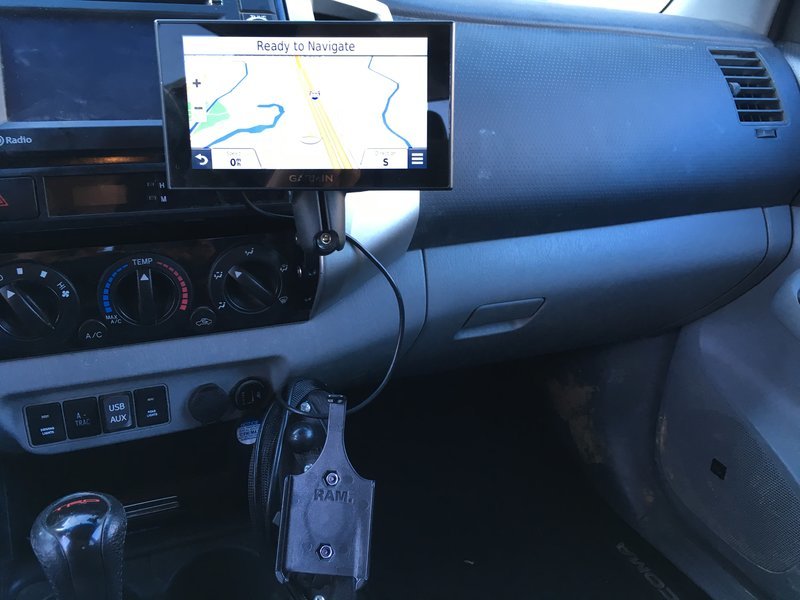

    No need for an apology. This thing is stellar. Road test this morning over some of our magnificent roads confirms that this mount is every bit as solid as the dash. Even with my E rated tires and really stiff suspension. Thanks again!
