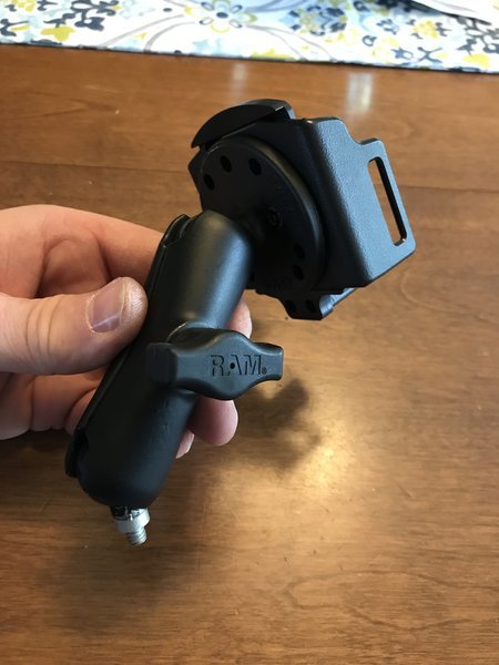

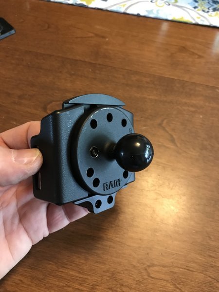

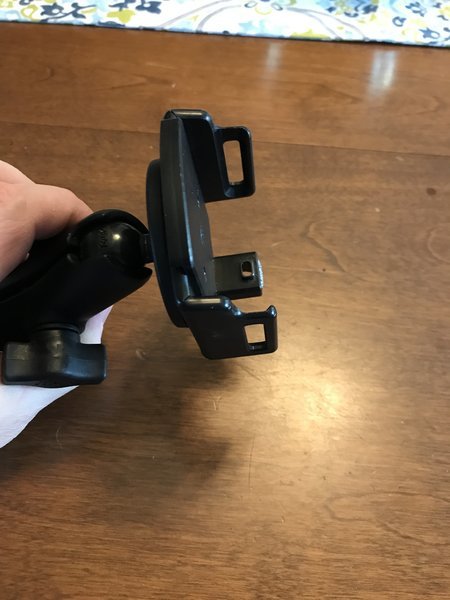

    While waiting, here is what I plan to mount. On the right, I'll plug iPhone into this:
    I'll swap an iPad mount on that side when we use one.

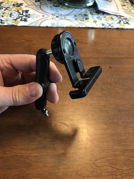

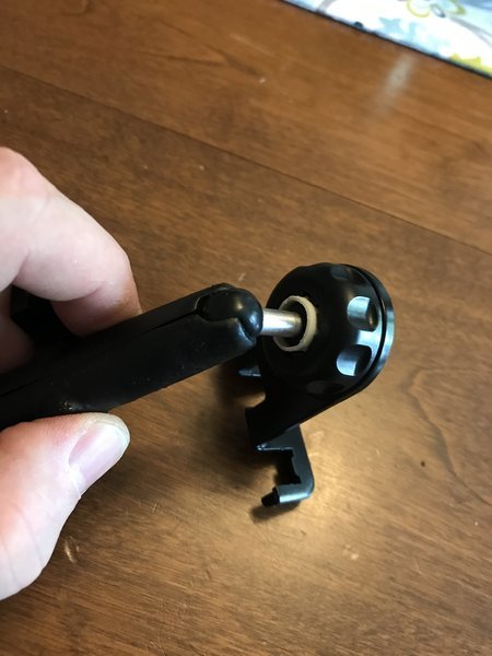

    On the left, my Magellan:
    To get the small dogbone to fit in the Magellan cradle, I used a small piece of plastic tubing that I dropped into boiling water for a few seconds so that I could stretch it over the ball. Fits in there snugly!
    I wanted these cradles because they both provide power when the devices are plugged in. No cables flopping around.
