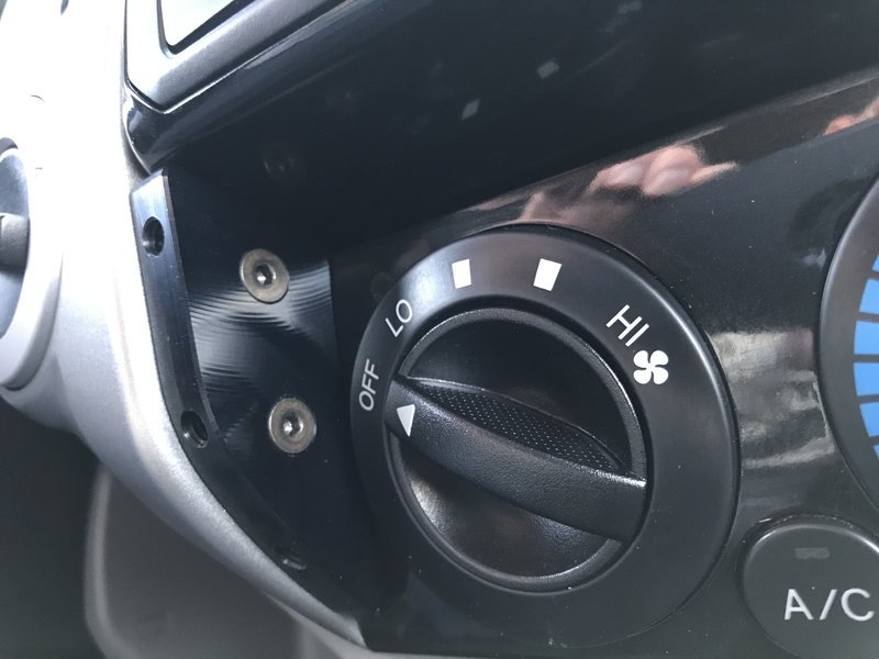

    Mine arrived yesterday. They look wonderful and I'll post a picture once installed.
    Thank you very much!

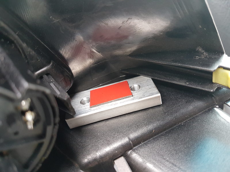

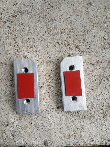

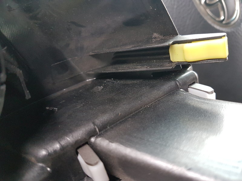

    Installed mine today! Really stoked how they came out, but it took me a lot longer to get there than I expected! Locking my keys in my truck and having to break in through the rear sliding window didn't help...
    I took some pictures for you @Lostsheep my truck is a 2006 for reference. You can see that the backing plate could not fit between the main part and that brace post, which is what I massaged out of the way. I forgot to take any pictures after though.
    I also could not get the holes to line up, and had to grind the corners to get them to line up properly.
    Once I got them in though, I am very happy with the final product!

    That rib is what I had to take a dremel to in order to get mine to fit as well. I think if the backing plate was ~1/8" thinner it wouldn't be an issue.

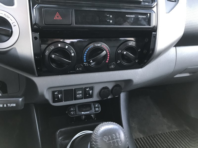

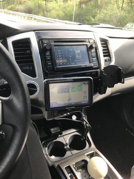

    Just one more...
    Lostsheep[OP] likes this.

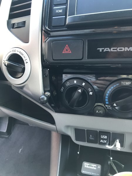

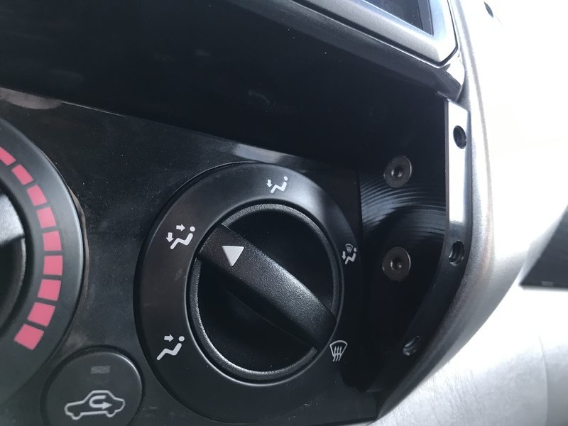

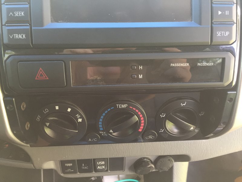

    Installed!!!
    My only word of advise is to secure the metal backs with a little extra tape over the entire things. Even though I cleaned where the 2 sided tape would stick to the plastic beforehand; once I stuck them on there and put the plastic back on the dash, one fell off and I spent 45min trying to fish it out of the tiny tight little crevice it managed to find. But once I found it, I taped the shit out of it and put the dash back together... and they look great and they're solid as eff. Excellent job OP.
    Now just waiting for my ram stuff.

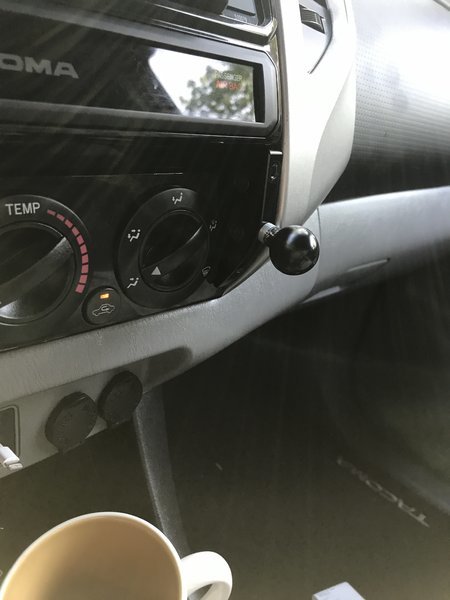

    Got mine installed and couldn't be happier! Seems very sturdy. Took a little over an hour and a half.
    I did have to trim the corner on my backing plate a little bit like mentioned above.
