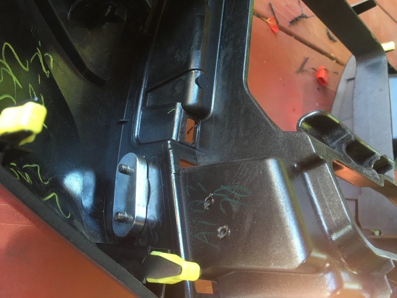

    yes, I have done the mods
    Completed my install on my 2012. Smooth, no hiccups. Fantastic product.
    Found it helps to unclip & remove the 4WD switch to get room enough to access the driver's side backing plate.
    Toyota did redesign the stereo / A/C vent surround trim panel in the 2012-2015 model year refresh. I'm guessing the intermittent install issue reports with the backing plate not fitting with that little plastic brace protrusion is due to the 05-11 panel being different than the 2012+. In my 2012, there was no plastic protrusion to get in the way, no backing plate trimming needed.
    (passenger side pictured).

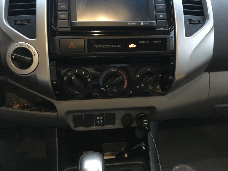

    Anyone happen to have trouble after the install with the airbag light coming on, hazards, and the little security lock/ Passenger side airbag light not working? I had one connection that didn't plug into anything on the radio. Seems like that went somewhere.. looks like I'm going to have to tear it all back apart!

    If the leftover plug was a long one, it goes under the radio to the hazards/clock panel.

    I am by no means an expert on this but it sounds to me like one of the plugs is not fully seated or perhaps a wire got yanked out of the plug. Based off of your comment about having an extra plug, I'd say start there and find it's proper socket.

    Nah dude. Super simple fix. Just take everything out again and you'll see that you missed the plug that goes into that bar under the radio which houses the clock and air bag symbols. I did the same thing. Just forgot to plug it in.

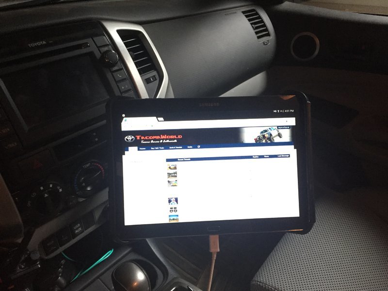

    Finally got my ram mounts order in to mount up my 10" tablet. I haven't gotten a chance to drive on or off road with it yet, but it feels like it'll be plenty solid. I'll update with a review once I get some wheel time with this setup.

    Man you guys are great! Totally forgot about the plug below the radio. Took 5-10 minutes to pull it back out and boom everything is good. :thumbsup:
