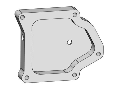

    Also, as a teaser, before I went on silent running, this got cut as a geometry check. This is just a geometry check to make sure I got all of the holes lined up. I am examining all possible solutions WRT how best to achieve the desired function; i.e., ease of install, keeping ECU signals intact, durability, and ease of manufacturability for keeping costs down. I'm going to make at least one for my own rig and if I can spit them out for less than the cost of an ADD I will run them.As an aside, I will gladly trade busted ADD's for a set of these RAM mounts. I need as many different years as possible to check for differences. Capture.jpg

    I'm guessing it's to turn our electronic ADD into a manual one. Just means you'll shift into 4wd with a lever instead of an electric switch. I believe that's what the ADD is.

    Mostly correct. It will allow for manual engagement of front diff, the equivalent of "locking the hubs". Shifting the transfer case into 4 wheel drive is still done through separate mechanism - also an electric actuator for tacomas by default, but there are oprions to make that manually shifted as well by swapping in a FJ-Cruiser transfer case, which still had the J pattern manual shifter.

    I hate the electronic actuators on my truck so I am swapping to an FJ case and would like to convert the ADD to manual operation via a cable. The trick with the ADD is keeping the 4x4 ECU happy; I am unwilling to give up my Atrac and I have no idea what signals the ECU needs to see to keep it happy. My initial thought was to replace the plastic housing to hold the engagement mechanism but if the lower cast aluminum component can be replaced then all of the sensors for the ECU and the breather can be retained so that is my current thinking.
