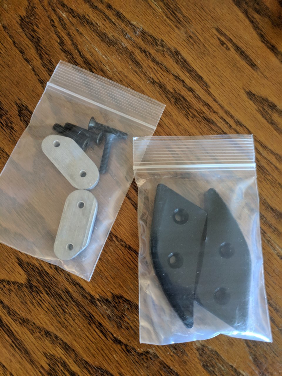

    so do you really need to fully pull apart your dash to install these? Can you not just drill in place without removing anything?
    TacoDude 72 likes this.
  12. Jul 6, 2018 at 9:21 PM
    #852
    Lord Helmet
    Lord Helmet Prepare To Attack
    Aug 30, 2012
    #85875
    39,164
    Nick
    '24 X3 M40i
    Nope, you gotta have the backing plates behind the plastic trim or else it won't hold ANY weight. It's super super easy to take the radio and ac controls out. It was my first time doing it on my truck and it came out perfect! :thumbsup:

    I can't guarantee that your dash will take this amount of weight for a prolonged period of time but what I can partially address this.
    I've hung my 8.4" Samsung tablet off of the driver side on 2 extended offroad trips. You have to hang it so that the weight is trying to tighten the RAM ball or else the bouncing will loosen the thread. We did about 50 miles on dirt roads for the eclipse up in Oregon, about 60 miles in Utah through the Northern loop of Capitol Reef NP, (all offroad) followed by about 75 miles through Escalante Grand Staircase (again all offroad) and the mounts held with no cracking of the dash and the tablet didn't fall off or out once. It bounces a little but I don't think that is a bad thing because if nothing flexes then something will break. It also withstood 1800 miles of road-tripping miles but in my opinion that doesn't count as a real test.
