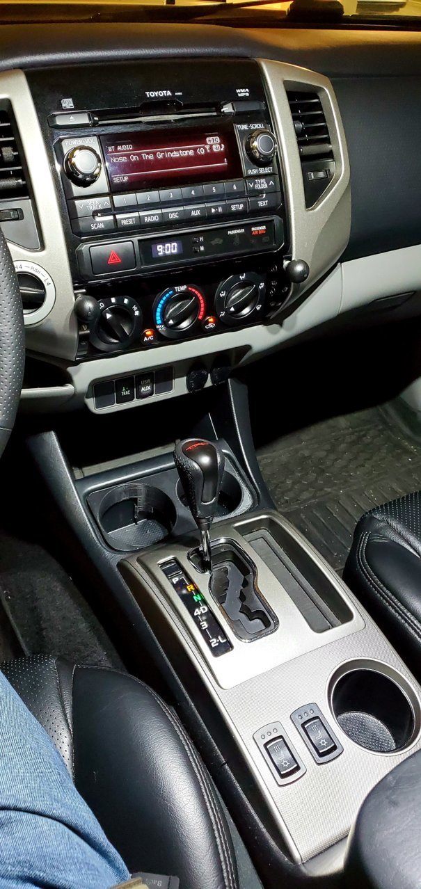

    Received mine today as well as many others. Just finished installing, took about an hour. I marked the holes to drill, before and after removing the dash components, and was still a little off requiring me to enlarge the holes a tad. Got everything snugged down and could not be more thrilled. Can't say thank you enough @Coop68 for bringing this product back!:cheers:

    Plan on uploading some in the morning! Figured it was too dark. Also, DON'T BE A DUMBASS LIKE ME AND FORGET TO PLUG BACK IN YOUR 4X4 SWITCH!!! Just had to tear the dash apart again just to plug the switch back in. On the bright side the backing plates and everything held up so I have no doubts about them going forward:bananadead:
