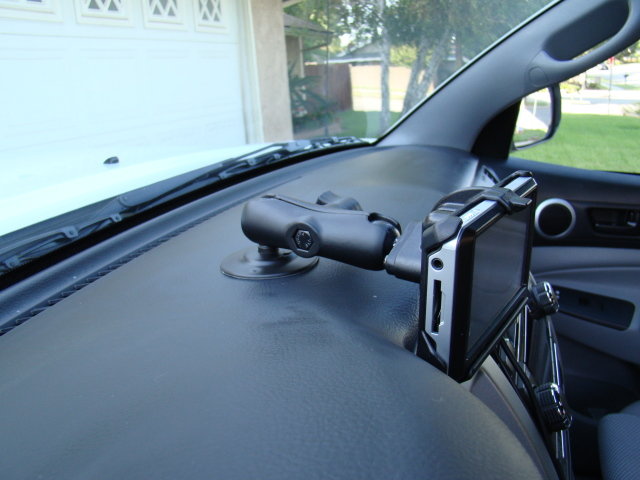

    So basically I'd be doing this but using screws to secure to the dash instead of a suction cup:

    Yeah that thing should be plenty sturdy. Last thing 'I' would do is drill holes. They do make a stick on circular pad for the suction mount that you can stick on the dash. That would be the way to go if you really want it on the dash and not the windshield. But again, the suction mounts are probly going to be just as sturdy as screwing it to the dash. And when you get that mount up, take a video for us if you can and show us!:)

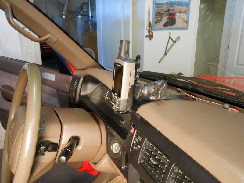

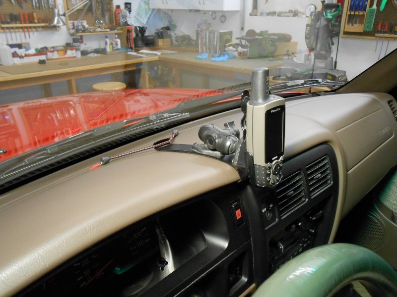

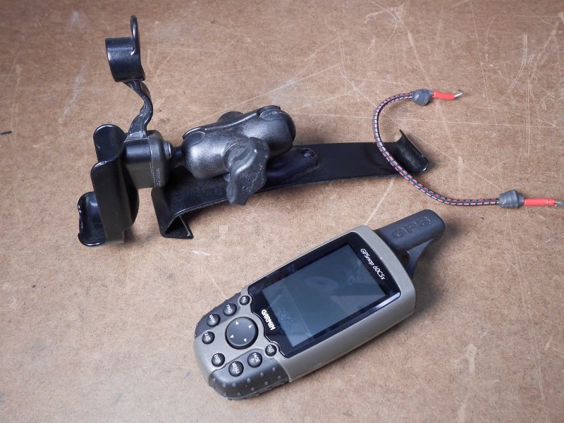

    Not brave enough here, so I went this way. There is felt on the bottom so no marks. It uses the Ram "short" adjustable mount and Garmin CSX cradle.
    Its pretty sturdy but if I did it again I would start with at least 2.5" wide aluminum strip. This one started with 2". By the time I got the compound curve to match the dash and trimmed the sides parallel it's down to about 1.5". The mini bungee hooks needed a new shape to hook into the dash louvers.
    The hard wired power cord lays in the gap between the dash and glass. It can be seen in the second pic near the bottom of the pass side pillar.

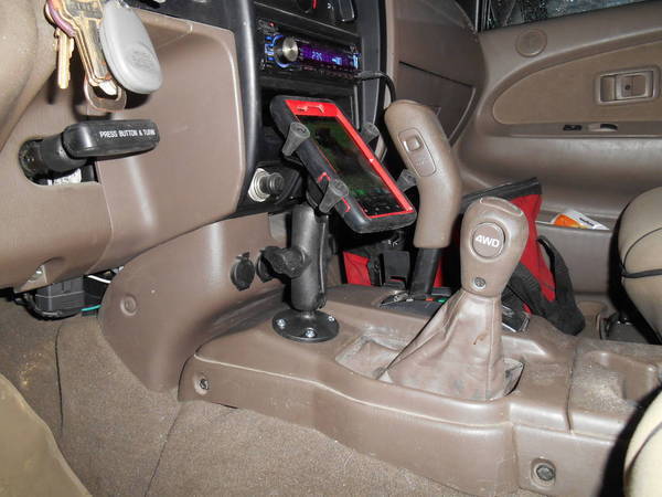

    I've been very impressed with the quality and versatility of RAM products. Have used several different ones over the years on my fishing kayak (rod holders/Fishfinder mount) and about 6 months ago I installed a cell phone holder in my truck; not on the dash but in the console. I believe its called the X-Grip
