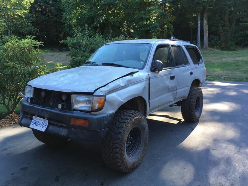

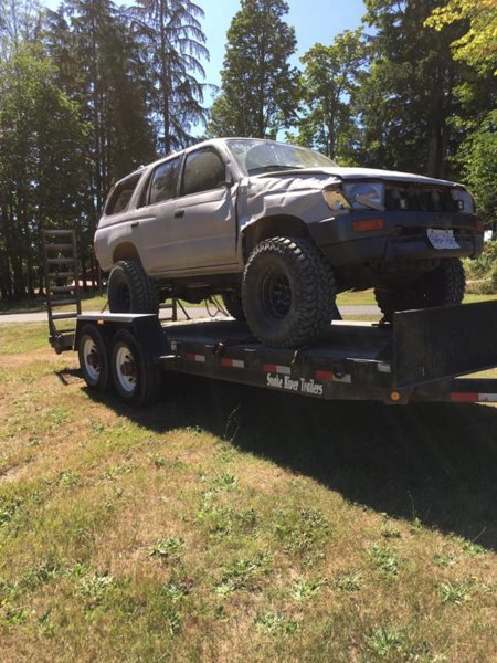

    i own a 1996 4runner, lifted on 33s and was a great time until a buddy of mine while trying to teach her standard flipped it on a logging road.
    lesson for me there with trusting other people!:mad:
    anyways, mechanically the truck ran other then a cracked rad. but the shell is crumpled, what used to me a mint body now became a tin canupload_2016-10-16_22-28-30.jpg
    you can imagine im pretty chapped.
    so i said screw it, it has potential and i knew it would come one day. one tons.

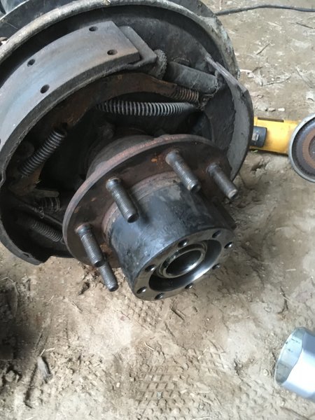

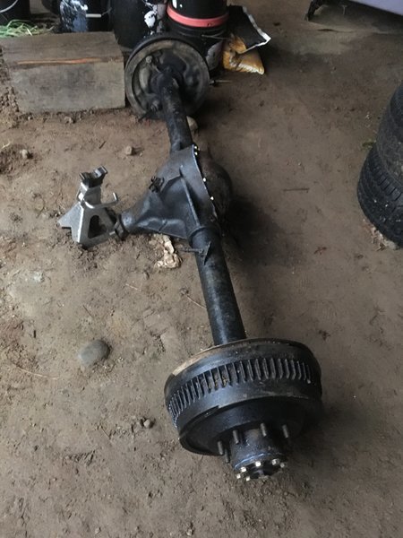

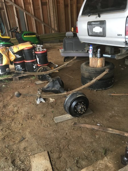

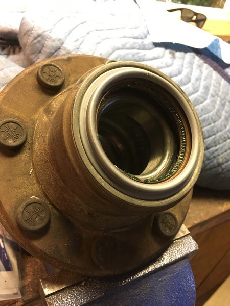

    So I picked up 1998 ram 2500 axles for 200$ since I'm starting on the rear of the 4runner I prep up the rear axle
    Flushed the axle
    Axle seals
    Repacked all the bearing with a light amount of grease
    Cleaned all the old mounts off etc
    Filled up the axle with synthetic oil
    New gasket

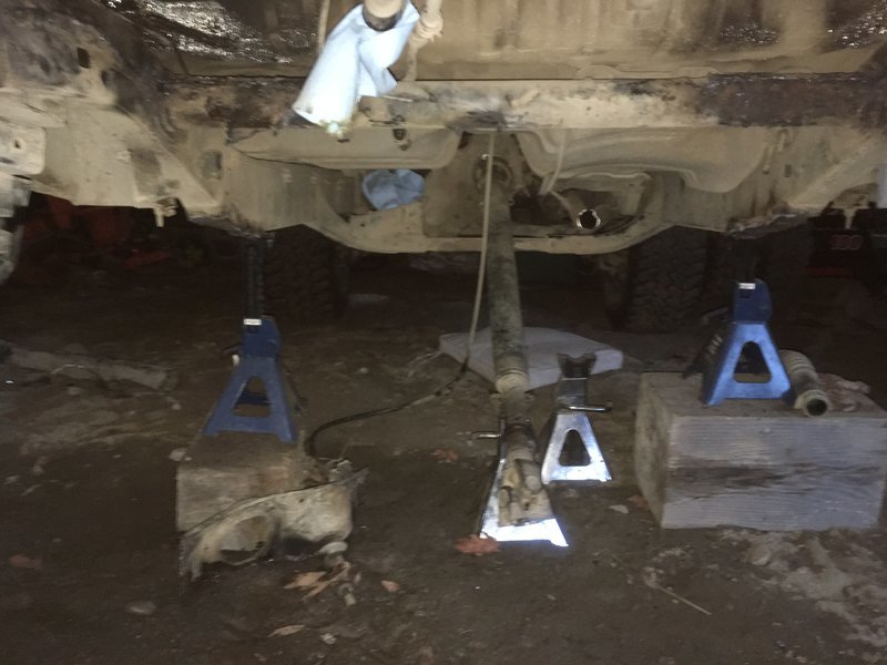

    So axle ready for mounts and brackets I remove everything from under the ass end of the runner.
    Get my hands on a torch set and go to town
    I still have to grind all the little bits of metal that's left after torching.
    Now I'm just contemplating weather to go out and buy hangers and perches or trying my best to fab a set up?!IMG_0406.jpg

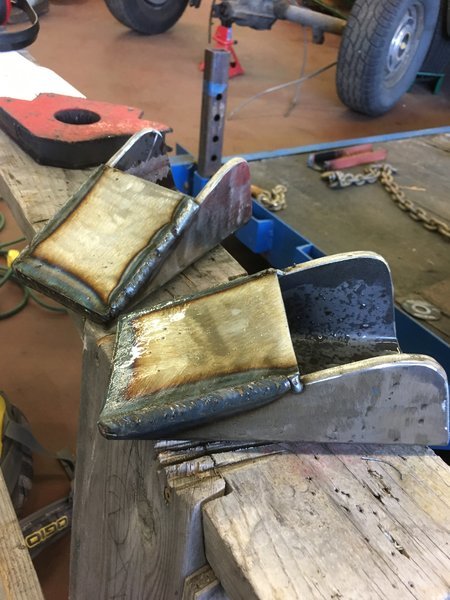

    I'll stop being lazy, I'm building my own.
  8. Nov 9, 2016 at 2:33 PM
    jomandini
    jomandini [OP] Active Member
    Oct 16, 2016
    #199953
    25
    jordan
    4runner getting dana 60 treatment
    a whole lot
    Their 7in long, I added the brace for better sliding over rocks or just support I guess. I saw the ruff stuff hangers had em so I thought I should have em too eh. I'll drill the holes later

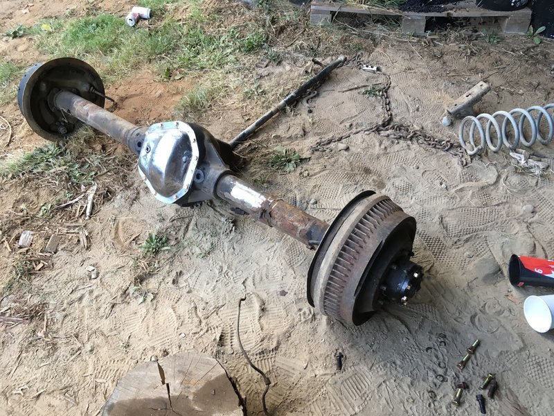

    I've cleaned up the axle. Bought leaf perches for the axle because they are cheap. I'll start makin the rear perches next week aswell

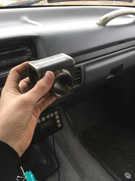

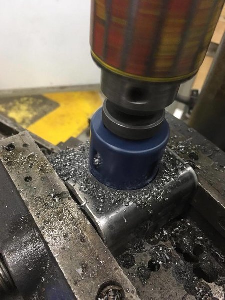

    making my own rear hangers

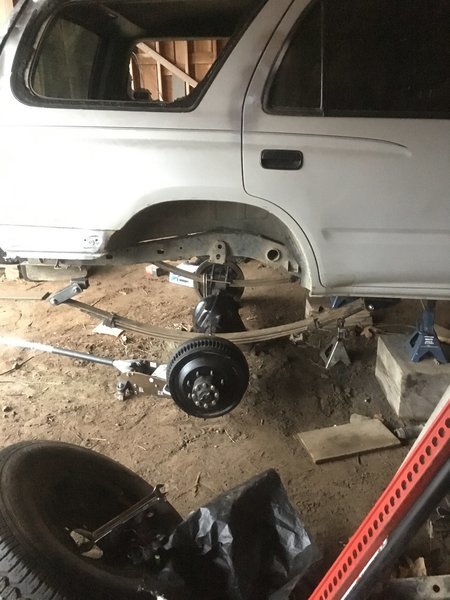

    Delayed... oops, any ways I've gotten a bit more done
  18. Jan 17, 2017 at 3:07 PM
    #18
    jomandini
    Oct 16, 2016
    #199953
    25
    jordan
    a whole lot
    I pulled the over loads off, new leaf bolt, had to drill out the axle perches I bought to a 9/16 to fit the new bolts. Getting everything lined up. Grinded more of the frame clean underneath... it's on going because it's a Pain in the ass

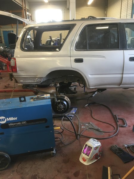

    I tacked the front hangers in, I laid the weight of the truck down. This is at ride height. And how far back the axle is going to be to help with the longer wheel base plan
