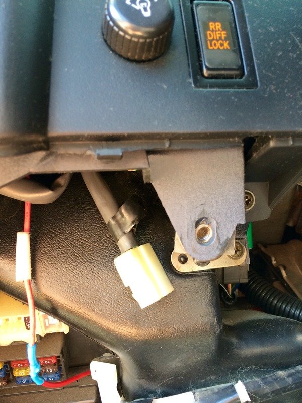

    stock
    the switches will go here:
