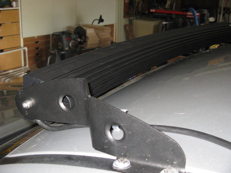

    Got it all mounted up. Not sure why it looks like the brackets are scratched up, they aren't. Nathan and I figured out the major problem but now for the minor one.. I had to mount it so the wires come down on the driver side or else they would be pinched coming out of the bar when I tightened down the bolts. The space between my windshield isn't big enough for me to squeeze those wires in on the drivers side. I have to figure that out but other than that just wiring it up and I should be done (knock on wood).
    You will need someone else when you put the bar on to hold one side of the bar while you get the bolt in, biggest pain for me was getting the bolts through the rubber strip.
    If you want I can do a write up on what exactly I did, don't have pictures but i can do the best I can.

    Great job Brian! I Plan on removing the rubber conduit surrounding the wiring to the bar, so that i can easily hide the red and black wires between the windshield and A-pillar.
    Glad i could walk you through the process for the most part :cool:

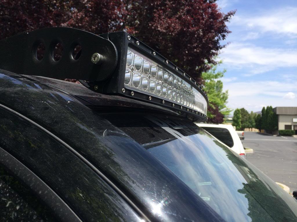

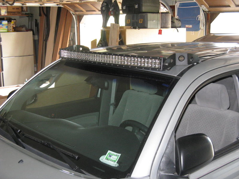

    Here you go guys, 52" Rampage RDR mounted up.
    4FF5920F-69EA-4F87-9BDB-A37A94532753_zps_94368fd492971f247dff214d0c0a2c83cb4c7a98.jpg
    357F6596-3A19-41F9-9DEF-2A5EC0DCCB82_zps_58892a9c2f5167ea132f35b3365547ade7274f2b.jpg
    Will wire and get some night shots this weekend.

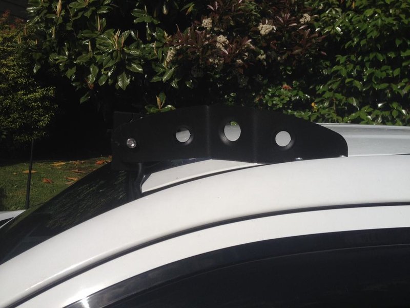

    This is from Nathan directly:
    "there are only two holes per side on the front of our trucks. If you lift the rubber weather strip up, you'll see were the holes are "taped" from the factory, then was painted over... i used a screwdriver to reveal the two M6 mounting holes. (they use these for the factory roof rack.)
    from this point, you can locate your drilling locations on the rubber strip."
    What I did was get eye level with the roof and hold the drill up to the hole facing across the truck (driver to passenger or vise versa) and then let the rubber strip down and see where the drill bit was with the rubber. I have a pretty good eye at guessing where the holes are while just looking at it from an angle. I used a 1/4" drill bit because I wanted the hole to be slightly smaller than the bolt so it was tight, making it more water resistant.
    I know Im not very good a describing but its hard to explain.

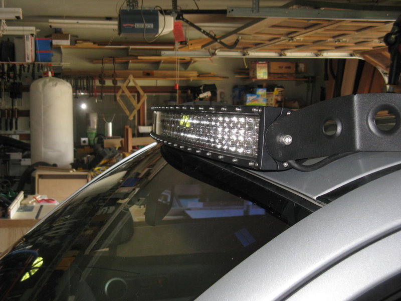

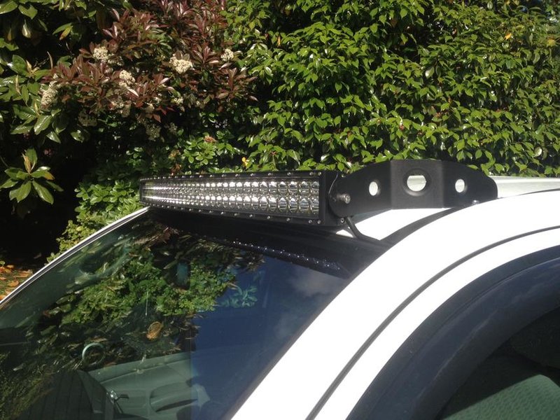

    42" Rampage installed w/ mounts
    Now after installing and being super pumped to use it, I have gained a ghostly whistle from the fins of the light bar. Any ideas on how to get rid of the whistle?
