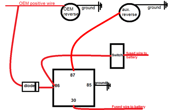

    There is a way to have them run off the reverse lights and a switch. Give me a second to make a diagram...

    Here you go...
    The diode needs to be facing so that the line is on the side shown in the picture to prevent power going through the oem wiring when you turn on the switch...
    I'd try a 5 amp diode...

    Thanks Brent!

    Makes sense looking at your diagram, I'm just bad at drawing them. Hated the electrical classes in college :anonymous:

    No problem! I have to dumb it down just so can understand what I'm looking at... :eek:

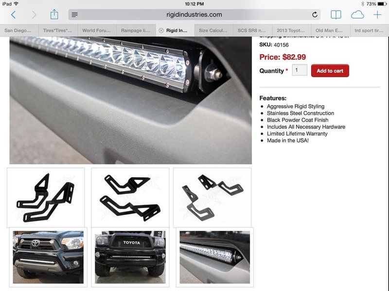

    Do you think the mounts in the attached pic will work with the 32" bar in the lower front bumper? I'd rather not "wing" the mount and end up with vibs or bouncing. Thanks!

    Can't say for sure. But I would try it out.

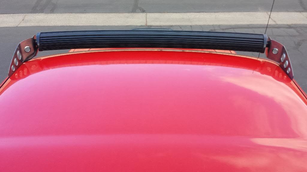

    OP list was updated earlier and I just finished mounting and wiring my RDR42 onto my truck. Night shots to come later! :D

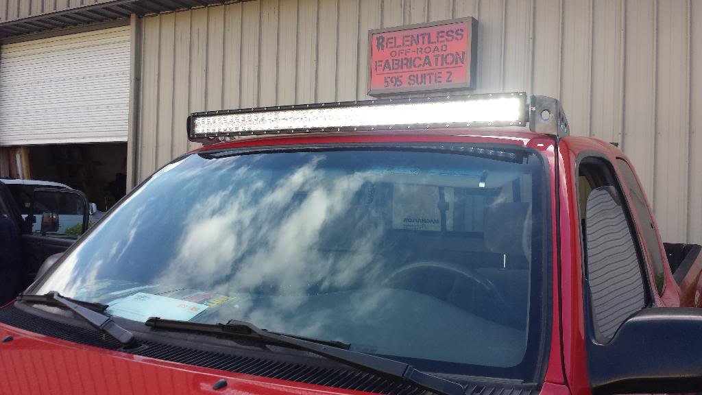

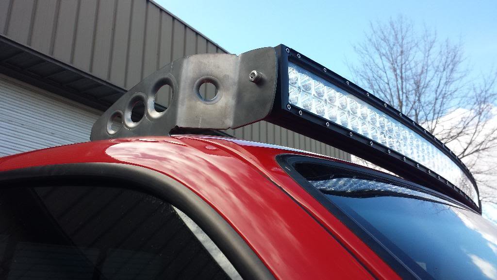

    mmmm
    More to come

    That looks awesome!
