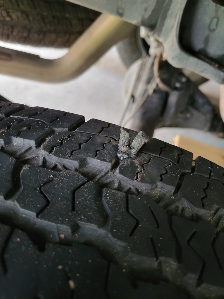

    Hello everyone. I'm on my first Taco, and ran over a fat roofing nail, went right through the outer tread (not a groove), tire went completely flat. It's the original Toyo. Been running on the spare for a few weeks now due to my work schedule :ballchain:
    I've taken the flat to two shops, a Town Fair Tire, and a local guy with a good reputation.. Both say it is not repairable. I'm thinking I should just buy a new one, but how much of a problem would it be paired with the original? Also the TPMs issues are new to me... please help!
    Thank you :thumbsup:
    Edit: to be clear, it's not a sidewall puncture, it's the ground contact part of the tread.
    Update: Thank you everyone for your suggestions. Couldn't post a pic because the tire was still in the shop. I'll try plugging it, and if that doesn't hold, go for a new one.

    How close to the edge? If you are really opposed to buying a new tire, you might buy a plug kit from Amazon and give it a go yourself.

    1/4" is the max size for a repair on a P rated tire, so unless you drove on it for a while, (wallowing out the puncture or damaging the inner liner of the tire), or it not in the flat area of tread, it should be repairable.
    Otherwise, a new pair of tires is needed. TPMS should be unaffected by a flat, unless it somehow got damaged while flat, or is damaged by the tech changing the tire, you shouldn't need a new sensor.

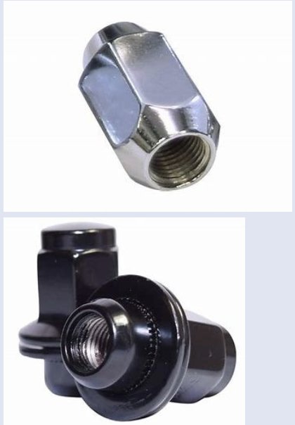

    If you have mag tires, check the lugs on the spare for tightness. This picture shows the difference between lugs needed for steelie/spare and mags ... the "cone" is critical for extended use of the spare. Top is for steelie, bottom for mag.

    Put a plug in it, and don't worry about it.
    Most likely, it will last the life of the tire. Every tire I've plugged has held air until I wore it out. A hole in the corner or on the sidewall (as you said yours it not) will not hold a plug as well due to the way the tire flexes.

    I just plugged my original Goodyears this week with the rope style. I've used them on cars, trucks and motorcycles with great success. OP take a picture of where your puncture is so we can get an idea of what's going on and if it's safely repairable.

    I wanna see the verboten location of the puncture. :duel:

    hey rabid bunny. whats the part # of the steelie lug nuts
